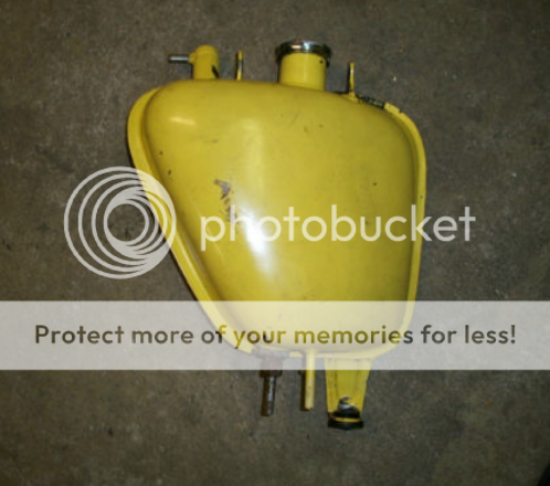

found a perfect un-dented, un-cracked, and un-corroded oil tank:
along with a set of stock 1964 battery/oil tank mounts to use to hold it up:

found a perfect un-dented, un-cracked, and un-corroded oil tank:along with a set of stock 1964 battery/oil tank mounts to use to hold it up:
Just a heads up for you, the top mounting for a 63-65 tank are 2 vertical tabs across the bike, the later 66 onwards tank you have has 2 rings in line with the wheels on the bike, it can be adapted by adding 2 tabs at right angles. Then you get the 6 pint capacity instead of the 5 pint for the 63-65.

you are quite correct, as i discovered when i tried to fit it. i didn't know that at the time.
but i found a 63-65 in reasonable shape, so maybe i have solved that problem. it is a bit smaller, though, and will need some repair to some bad brazing at the mounting tabs.
the newer one was a real beaut, tho
As did mine, they all have a repair here and that's why they went to the rings, your bottom mount is for 63 only and breaks off due to vibration so try to insulate it with a rubber washer or mount.
i never knew the taxonomy of triumph oil tanks was so complex until i tried to find one for this 64 frame. i just tried the newest oil tank on the frame and you're correct - - there isn't room for the more common C-shaped support bracket under the tank. but it does look like it will work, with some cushioning.

An this is what I have done with the Indian so far.
