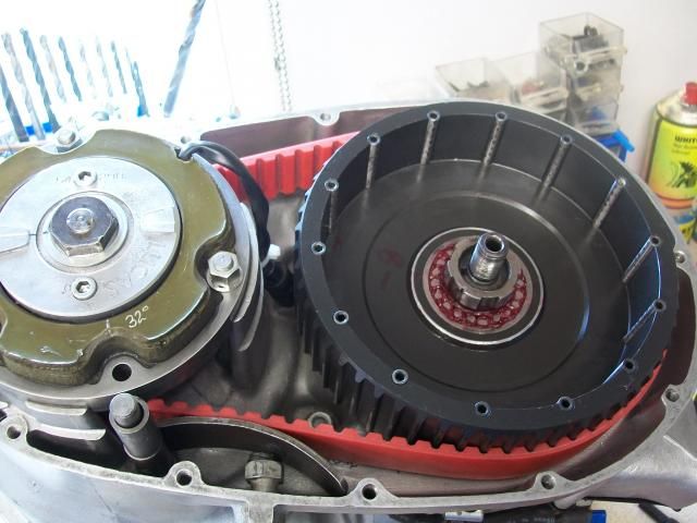

New clutch centre ready to be fitted clutch drum has still to get locateing pins turned
New belt fitted checking for clearance

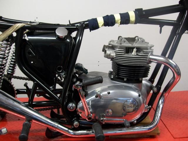

Bottom end built all new bearings bushes seals laid on its side to lay frame over it
Engine now in frame with jugs on jugs blasted then done with oven black the same process as your cooker has in your kitchen
Bare head vapour blasted only on temp to check downpipe fits with bottom engine bolt
Next job get head built it has the full monty done by Srm Large valves plus flowed out sucks of a pair of 34mm mk2 AMAL carbs

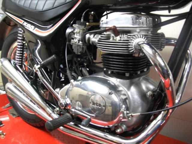

Nearly finished the 840cc should have been ready last year but i took a wee stroke plus the computer crashed and i have lost all the pictures of the rebuild, all thats left to do is fit the bunn breather system and tidy up the cables under the tank fit the number plate so due to come off the ramp then i can start on the venom, This rebuid was a complete strip down every nut bolt washer all stainless all new bushes an bearings in eng an gearbox new wheel spindles taper steering head bearings new swing arm bushes all cables wire harness belt drive surflex clutch plates ect Boyer elect ignition an power box carbs overhaulded in fact it is as good as new should keep someone happy for a good few years.
Bsa x65 spec
1968 Lighting
Out to 840cc
50Bhp at 6300 rpm
A10 Dynamically balanced alternator crankshaft with the srm oil feed conversion
A70 rods with steel caps
Srm oil pump
Srm barrels the space between barrel and cyl head is because there was not enough room to cast on another fin
Nourish Z profile cam
Bore stroke 79x84
Srm gas flowed head with 44mm inlet valves also same combustion chamber shape and piston crown shape as the v12 jaguar
Rocker shafts reworked
Pair AMAL 34mm mk2 carbs
Belt drive primary
Srm built wheels
New tyres tubes ect
Bike was clocked at 99.4 mph 13.45 seconds over a quarter mile
Sorry about the poor pictures need a new camera.
