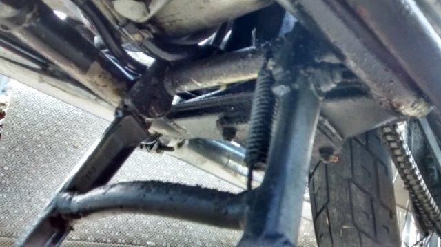

Check the lower frame cross member that carries the center stand, they often crack at the joint with the frame tubes, and mine was completely broken away. If yours is cracked, there are reinforcing tabs you can fabricate and weld in. (Alex supplied me with the diagrams for same, and Don made them up and welded them in.)

Great advice, RE cracks, can you point out exactly where you mean?

The cross member on mine was broken at the welds where it meets the side rails of the frame. You can see the gap between the weld bead and the frame tubes.
Not saying that they all crack or break, it's just something to look closely for while it's apart.
If there is a problem, I can dig out the info on how to fix.
Of course, lots to look for, but that one took me by surprise.

Thanks for this, Kurt.
My BSA will be on the table for some work and this is definitely something I will check for.

Nice looking Titan, nice simple bike, nice job.
Sounds like quite the BSA treasure trove you are rescuing.
As I understand it, vapor blasting uses a glass-bead slurry (someone please correct me if I have this wrong). I used to blast everything, then spend lots of time cleaning out beads, never felt I could get it all out. Maybe with a big ultrasonic cleaner perhaps. I did a pretty nice job on my BSA crankcases by hand recently. Finished off with a Caswell product "Aluminator" -- basically a phosphoric acid spray (with lots of ventilation). I might look into soda blasting at some point. There are endless discussions on media cleaning on this and most other forums smile

I don't think anyone has mentioned this but when you do get to the electrical system, don't forget that it is positive ground. Very important !! Welcome to the best site there is bigt

Kurt, I would appreciate the information on how you fixed your cross member. My 71 A65L EE frame has cracks along the weld. Thanks.
I will dig through my long rebuild thread and come back later today ...
... in a new thread:
http://www.britbike.com/forums/ubbthreads.php?ubb=showflat&Number=581981&#Post581981
