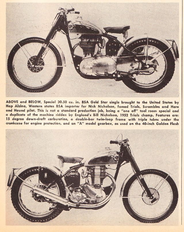

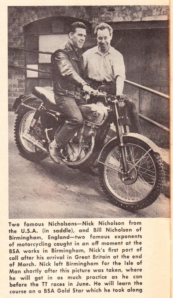

I went through all the 1953 issues of Cycle to see if there might be photographs of BB Gold Stars in places other than BSA advertisements (all of which show them with plunger frames. Here's what I found:
March 1953 'Cycle'
Even though the above is of a "special" it still should be of interest.
June 1953 'Cycle'
Either they swapped the nobby tires for something more appropriate for checking out the course for the TT, or this has to be a stock bike in off road trim rolled out for the "unposed" photograph. The angle of this photograph nicely complements the one from 'Motorcyclist'.
