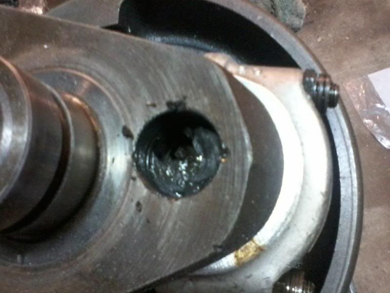

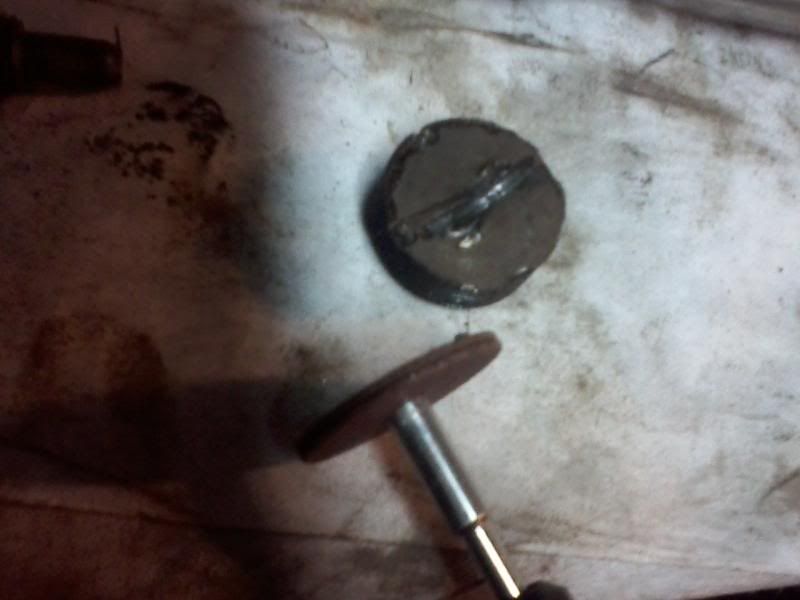

I had hastily put the motor together, but when I went back into it I found this!
The motor also had a ruined tappet and cam lobe, most likely due to lack of oil to the affected areas.
I found that if I took two of the Dremel cutting discs and used them together, I could cut a nice deep groove in the sludge trap plug and get a big screwdriver bit on an impact driver to pull the plug.
All the while, finding and perparing various parts.

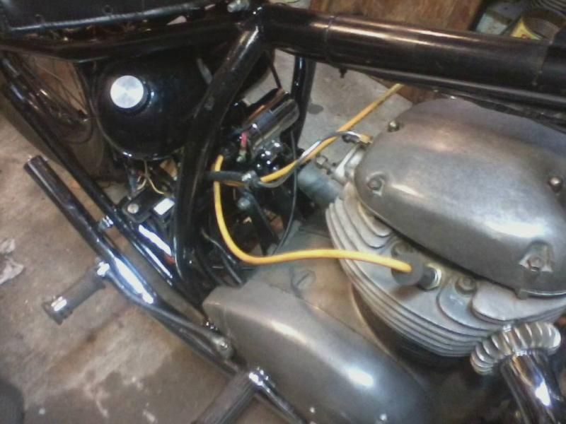

FINALLY got the coil in the mail and mounted. Kind of labor-intensive; I thought I could use the original coil mount brackets but the dual fire coil is thicker so I had to modify the brace that came with it. I had to cut the ends off, then drill mounting holes. Due to how the bolts go through, I had to use carriage bolts, which meant filing the holes square by hand, then grinding down the heads of the bolts so they don't interfere with the coil. All of the nuts that mount the P-clamps as well as the coil bracket are well behind the bar that they are mounted to, and below the oil tank in front of the battery. A real PITA to get a wrench on, but I have a ratcheting box wrench and a ratchet handle that rotates via the handle that came in very handy. And after the bracket was mounted I found that I couldn't just slip the coil into it, but had to bend the bracket open, then close it over the coil, holding it closed as I tried for about 5 minutes to get the darned nut to thread onto its bolt. Very glad to have gotten this done, and yes, the carb and air cleaner fit in their space with about 3/4" on either side! BTW, the P-clamps are heavy duty 3-piece jobs I bought from J&P cycles. (Harley parts catalog) Very handy little buggers they are!

Mocked up. Getting so close. I am waiting for a new jet for the carb and some #78 drill bits. I also still need to pick up a pair of light sockets for the speedo and tach, plus get the horn working. So close.
I read a different thread wherein someone suggested that the A65's design had the rear wheel in too far and the front wheel too far out from the frame.(In the author's opinion) I always though the rear wheel looked a bit tight, but I think in pulling the rear wheel back on this bike (6") really balances the look. I didn't touch the front.
