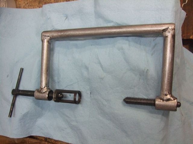

I've got a couple of these I made. Different sizes.
Harbor Freight and some rigid pipe.
Inch and a half of welding.
The collets drop into the pipe for easy retrival and reinstallation with a magnet.

Yes, mine looks very much like Don's, except that I have a thick flat washer welded to the end of the tubing. The hole in the washer is just large enough to clear the collets.
Funny, I've never experienced (or at least never noticed) the problem of the collets sticking in the spring retainers. Maybe because my spring compressor is so beefy (has a 4"-long handle)?
