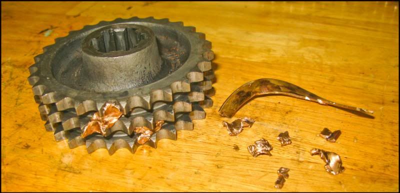

Looks like I found the problem.
Removed rotor and clutch basket. There is no play on the clutch shaft. Phew. Rotor looks fine. I'm ruling out bearings based upon what I found in the clutch.
The thrust washer was torn up and had fallen out. There seems to be more play in the clutch center assembly than this one slim washer missing, can account for though. I couldn't get the screws from the clutch center retaining plate out to take a proper look (soaked them in PB ready for tomorrow), but it seems like this play is in the cush drive rubbers. You can move the center side to side and also up and down. There's a ton of play in the clutch center, a good 1/8 inch at least.
Observing the noise with the case off had me focused on the clutch, the noise was in time with some shaky energy transferred to the drive chain.
Now I could be totally wrong back working back I'm thinking about possible causes.
.....All of this was exacerbated (perhaps in part caused by) the fact that the primary was very loose (around 1/2 inch play). It has been for some time with the PO, you can see where the chain has ground out some tracks on the inside of the cases. I'm thinking the heat of that long ride, and the over-tightening of the clutch on the side of the highway finally put the pressure on what was already a long term stress.
I'll let you all know how it pans out but I thank you for your time so far and appreciate the help and input.

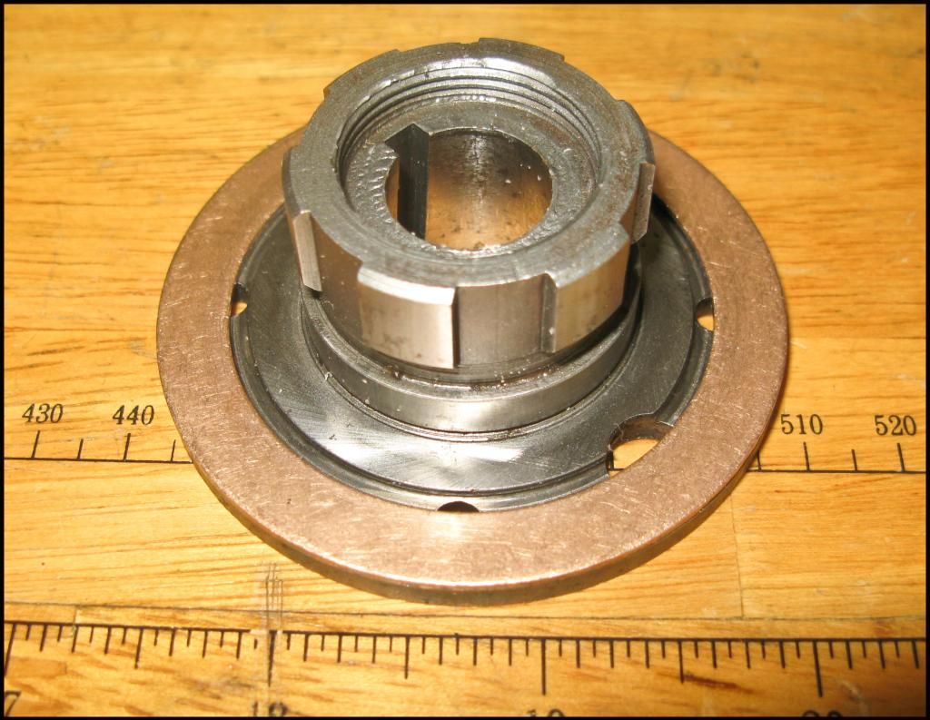

Mitch Klempf informed me that there's two sizes of that thrust washer with the same ID #. One is 1.880, the other 2.02"...I had to measure the inside of the center hub to get the right one.

PS: Looked at picture of damaged thrust washer. It was an aftermarket one made from brass. The proper earlier steel one (one side plated brass and two tabs) hasn't been available for many years! While the aftermarket all brass one has the right i.d. they are very prone to failure. IMHO you either should get a later hub, or live with the later thrust washer and let it float on the early hub (not the greatest solution).
This is one of those items you should not pass up when you see a later one at a flea market if you have an early bike. It will be just a matter of time that you will need it.
And yes a new shock hub assembly solves a bunch of other problems!!!

I'm uptight about spending money I don't need to, so on the third try of heating it up to near red hot levels I was finally able to get those screws out. The rubbers were so worn they just fell out. The whole assembly was super wonky actually, in addition to the rubbers and the washer, everything that should have been tight was loose. Gotta really locktite against all that heat and pressure I guess. Or, just not wait 46 years to inspect

Whilst your in there, get a new back plate and spider as these wear again teach other and generate a lot of wobble, then when refitting, use bolts that will go straight through the hub to the other side.
