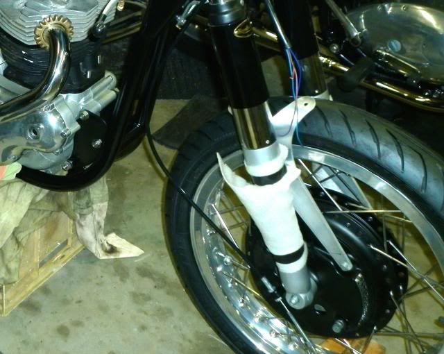

Then I have a 750 brake. I turned each side down just less than 1/4" to get the hub to fit the forks. I was wondering why the forks didn't want to compress when they were on the 550!

i once tried the suzi 750 tls on my dommie 99ss but the forks kept binding ,i tried every thing to get
them to work ,so i sold the complete front wheel only to find out later i was using the 7 inch triple
trees instead of the 7 3/8 triple trees

Use suzi 4LS hub in an 18 inch alloy rim. With well sorted road holders on triton 500 racer. Sensational brake. With no handling issues at all.
