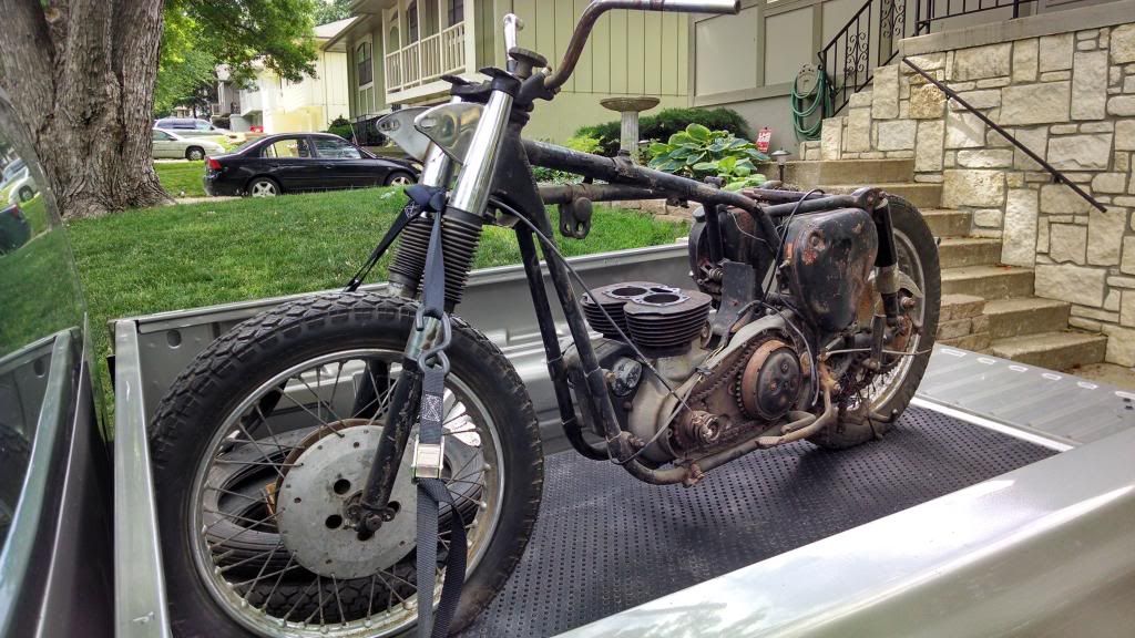

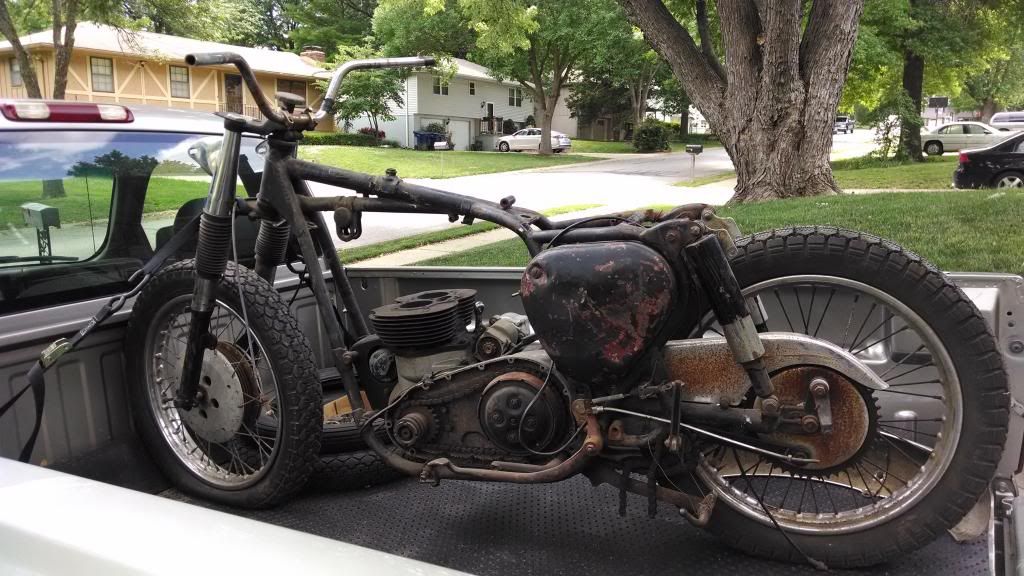

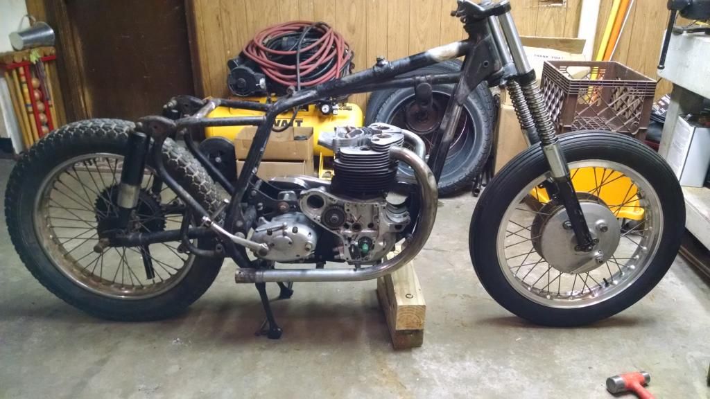

I had another one of these follow me home this weekend . . .
Fortunately, this one is not mine, but I will be restoring it for my good friend, Dan, aka BritTwit. This is a numbers matching '63 Goldstar Twin, despatched to Hap Alzina on 6/20/63.
Dan had accumulated many parts and a significant amount of information on his bike to provide me with an excellent starting point. This will be mostly a photo documentation of the progress, and as always, any and all information and comments are greatly appreciated.

Looks like a good restorable machine.
Do you have the correct fenders, fuel tank, cylinder head etc ?
I am looking forward to see the progress of your resto.

Someone would have to be insane to restore an A10 starting with such an incomplete bike... oh, wait,...
I'll be one of those who will be following your progress on this.

Thanks, Peter. We do have the correct tank, fenders and head plus a pretty good stack of NOS parts. The tank is in pretty decent shape and will be sent out to Ross Thompson for proper reconditioning. The fenders are older reproductions but very nice.
Bill - I have finely honed the art of multi-tasking. I have learned this skill from my wife who is in IT management. With as many projects as you have, I think it's best for you to just send me your T100R and I'll go ahead and restore that too.
Magnetoman - Compared to my RGS, when I started that project, this one is relatively complete.

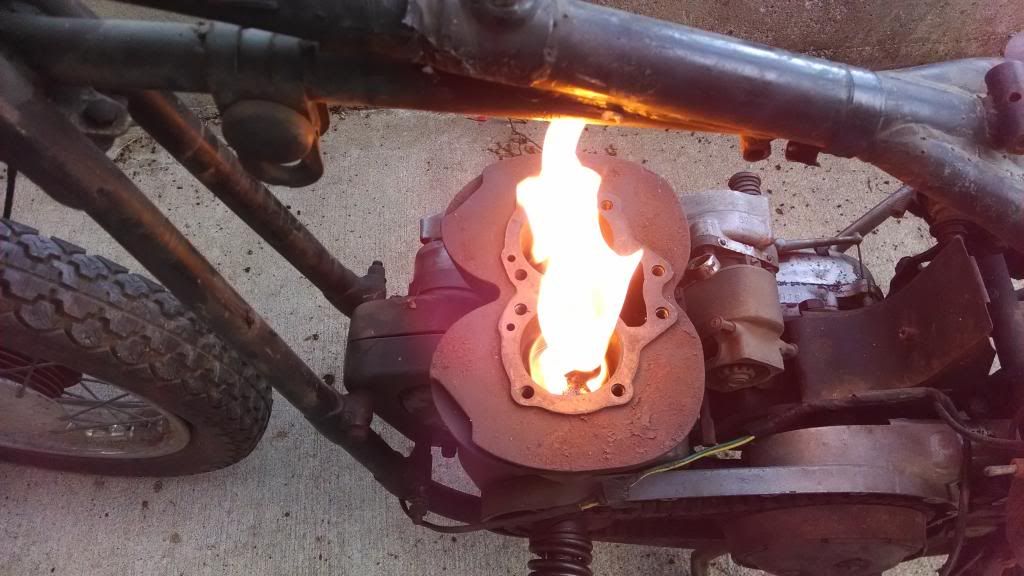

As for my progress so far, I have a severly seized engine. I tried slowly heating the cylinders with my heat gun and it melted, so I tried the Swan approach . . .
I did not succeed this evening, but with everything I've learned about British motorcycles, patience is key.
Until next time...

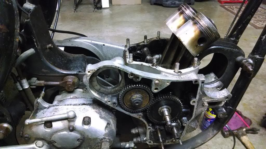

Well, it took a week, but it is finally unstuck. A mixture of acetone and ATF and a couple of hours each night with a heat gun, it finally broke loose today.
Right side piston was the culprit. The rings are locked solid to the piston.
This machine and my RGS both have this inner primary, it is the short-tailed, not drilled for the chain guard, but there is a casting mark where the hole should be drilled. I was told several years ago that it should be the long-tailed inner primary, like the Goldstars. Have any RGS guys had any experience with this? These were both west coast bikes.
Until next time . . .

Like I mentioned before, the frame has issues.
I spent several hours at the shop today building a jig and moving the frame around. I have achieved 27 degrees rake again, but I might still have a little side-to-side tweak. I will need to reassemble the chassis to check alignment. I have about 20 tons of moving power, way more than this frame needs, but these BSA frames are strong frames.
I also discovered that the inner primary is extremely twisted. Has anyone had experience with straightening cast aluminum?

Well, Brett, I've straightened a handful of motorcycle frames at the shop where I work. We are right across the street from a large Kawasaki/Honda dealership and we do a lot of straightening of ATVs, same, but different. Shoot me a PM about what you have and how bad it is. It can get pricey though; the frame machine I'm using is a $30k machine and the shop rate is $75/hour and the RGS frame took 6 hours so far.

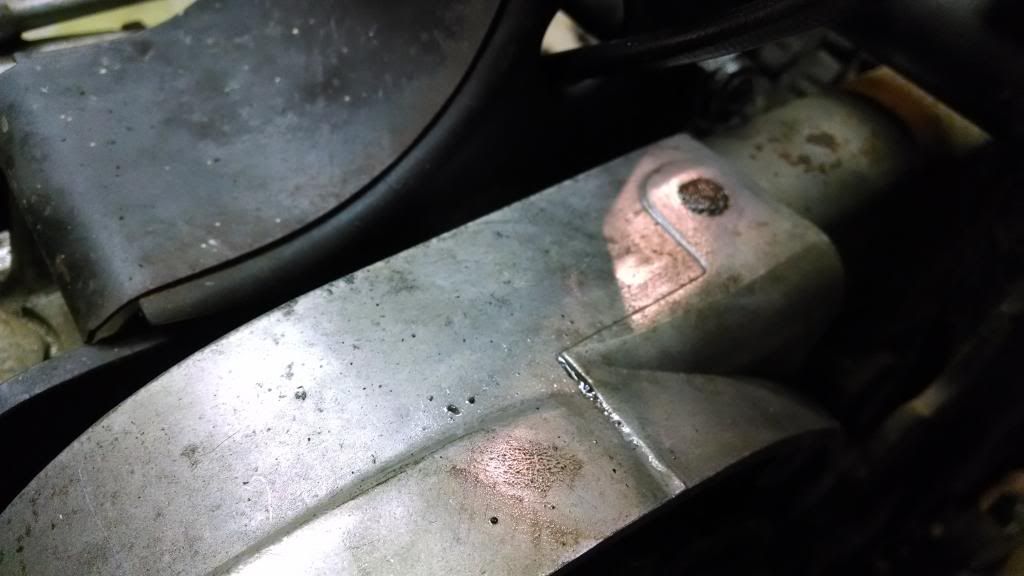

Good news on the inner primary. I remembered an old tech tip I read in "Twitter", the old Gold Star Owners Club news letter.
Cleaned up the threads with a 1/4x20 tap and cleaned up the screw holes.
Bolted up an old outer primary cover with allen head cap screws and torqued to 25 ft lbs.
Oven baked at 400 degrees for one hour. Let cool. (frosting optional)
What was one a 3/16" gap in the middle is now gone. I test fitted my NOS outer primary and it now has a nice fit.

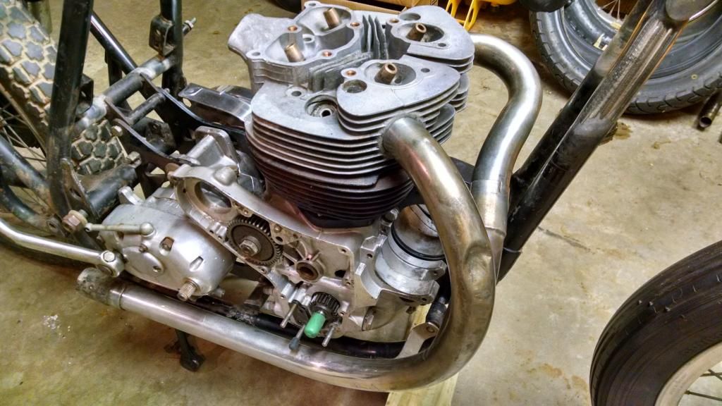

I finally have some updates on the RGS.
I have the frame where I want it to be. It was a little more work than expected, but now I can move forward with the restoration. With the engine and gearbox in place, I have mounted the siamese exhaust for fit and it far exceeds any after market exhaust.

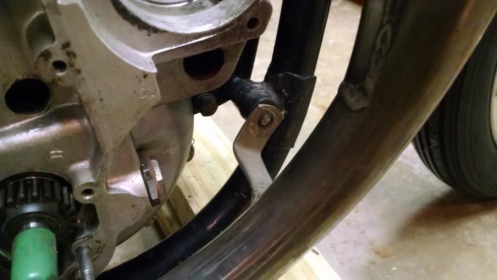

I just don't understand why anyone cannot make a decent exhaust to fit for the price charged on after market pipes. Below is an example of after market pipes.
Here is one thing that you won't see on an Armour's pipe:
It actually fitting!
The project should progress a little quicker now that I have everything aligned.
Dave
