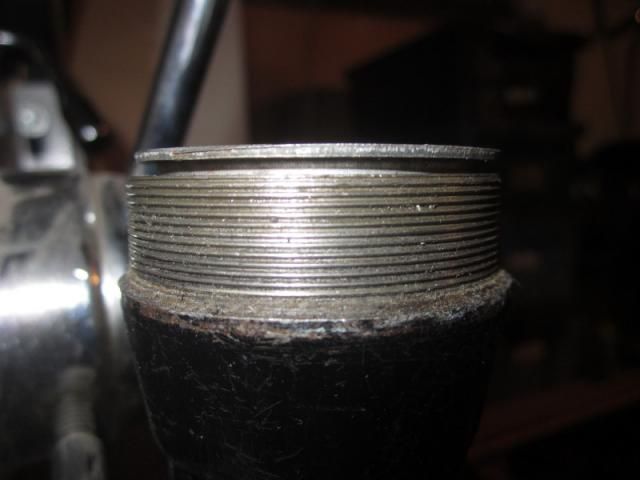

There is no grove on the fork bottoms/sliders.
It's just thread that blends out.

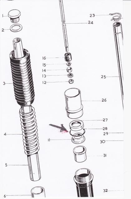

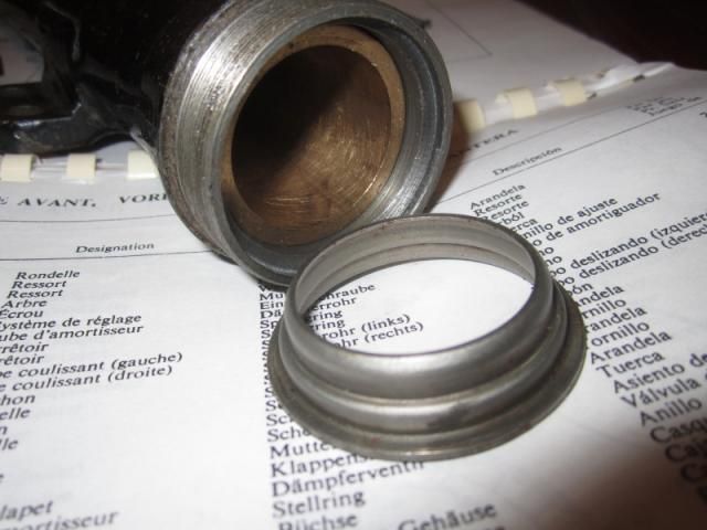

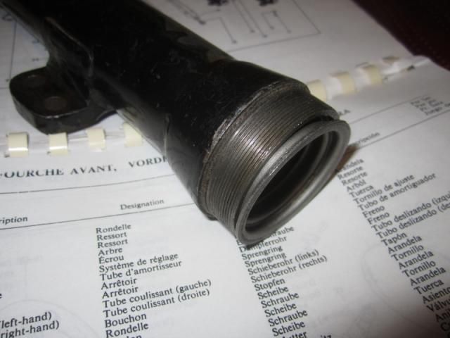

The confusion seems to be around the type of forks you have. If you have the 66-68 rod damper BSA forks you would have a fork slider without the earlier circlip to hold in the top bushing. As per this photo there is no groove in the slider to accept a circlip. Instead there is the special spacer shown that goes in small end first to hold the top bush in place.
The next photo shows the spacer loosely in place and what is missing is an o-ring to seal up the space between the end of the fork slider and the spacer rim. When the seal holder is threaded onto the slider the edge of the seal inside it pushes down on the spacer and compresses the o-ring.
What is strange is that my 66 and 68 A65 parts books do not show the o-ring but it is shown in the 69 and 70 B44 parts book that have the same rod damper BSA forks.
The 69 should have the Triumph style fork which has an o-ring inside a groove in the seal holder.
ah haaaaaa....very interesting thanks.
Still doesn't explain why the vendors spout that it's to stop "chatter". I think we'll put it down to judicious assumptions made by them when looking at the exploded parts diagram.

The 69 B44 forks I have taken apart all had the o-ring in place as per this parts diagram #28. The o-ring is #97-2682. I have always been able to order them locally. Without the steel spacer the top bush would just hammer up and down. Without the o-ring the spacer would still be loose and make noise.
What is strange about this parts book page is that the steel spacer #11 is shown upside down.

Looking at the diagram they have not just the orientation of #11, the stepped conical spacer upside down but also the location of the O-ring. There is no need of an O ring between the spacer and the oil seal as the oil seal rubber will seal just fine with the conical spacer when tightened down. The O-ring must go between the spacer and the top rim of the fork tube. I believe this would be to help seal the seal area from weeping oil. In other words to picture it just flip over #11 and #28 in the diagram.
I think you are saying that the O-ring is supposed to keep the bush from clacking with the spacer?? If the O-ring sits atop the fork slider it would effectively move the spacer further away from the bush and wouldn't reduce clacking at all. The top of the spacer is held by the fork seal. The only way it could be used to reduce any potential slap between the bush and spacer is if the O ring had the same ID as the fork tube's OD. Look at the bottom edge of the conical spacer in your photo and you will note it is tapered. Definitely not made for a compression fitting with an O-ring. The O-ring would be stretched back up it when tightening things down and would be good for nothing if that is what it was for.
To complicate tings further there are two different designs of the conical tapered spacer. They are of 2 different lengths! I just took apart some 1968 forks and the spacer is shorter and on these models there is no O-ring specified in the parts books. What ever to make of that. I think that BSA just intended folks to use the string for sealing at the bottom of the chrome seal holder at that point. I contend the O-ring it has nothing to do with clacking prevention with either the springs above or between the fork bush and spacer!

Peter: For sure the o-ring is not shown correctly in the parts book, I failed to notice that.
When my spacers bottom out on the top of the bush there remains a small space between the top of the slider and the lip of the spacer. The o-ring is slightly larger than that space and is compressed a little when the seal holder is threaded on. The compressed o-ring should stop the oil from coming out at that point. The actual oil seal edge would be tight to the top of the spacer so oil should not escape above the spacer. I still put string on the threads of the fork slider and have not had any leaks on the forks I have assembled.
This photo shows the gap. With the o-ring there would be no metal to metal contact between the slider and the spacer and thus quiet in the event of any movement. I agree that the spacer is the key to keeping the bush from moving and prevents the clacking.
