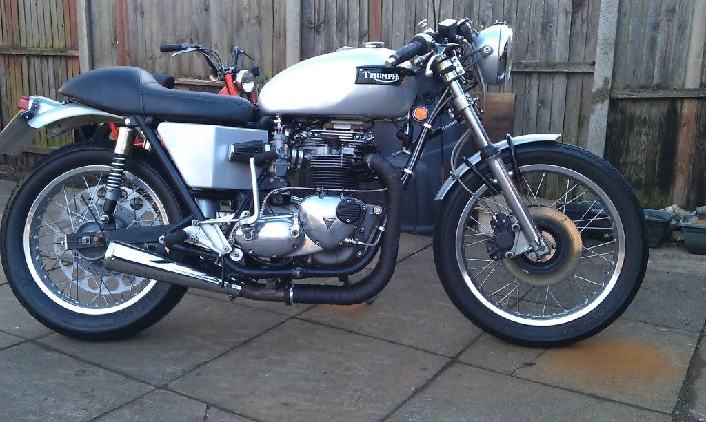

Hi Thought i would post my cafe racer on here, she's a 1976 T140V and pretty much how i wanted it to be with loads of home made parts,braced frame etc. I will list all of the mods in a later post.
Cheers VULTURE

Very cool. That's a pretty nifty rear brake setup, what's the story there?

Glad to see you posted here, Vulture. Commented on your terrific T140 on another forum, but I will say it again; very well done!

I reckon you have done well, go hard special builders. I might pinch the speedo idea can you give us a run down on your mods , specs please thanks brian in oz

This Vulture dude needs to get his butt back over here and fuill us ion on the list of mods / details.
Nice stuff, certainly a bit nicer than the aaverage oily frame cafe racer...

Hi Chaps Sorry about the wait.
Anyhow here's the list of mods
Standard frame braced and gussetted
Box section swing arm 2" longer than stock
Homemade alloy slab yokes
Homemade front fork preload adjusters
Homemade fork brace
twin disc with grimeca calipers with Suzuki Burgman master cylinder
Homemade clutch slave cylinder with Suzuki Burgman rear brake master cylinder
Quick action throttle with homemade cable splitter.
Homemade clip ons and bar end weights
Steering damper
Homemade header pipes Head converted to push overs
Mikuni VM34 Carbs on homemade manifolds
Standard seat base recovered cafe style
Homemade rearsets
Alloy rims with stainless spokes
Digital speedo running off rear wheel
Rear brake backplate drilled for cooling and bacon slicer
External oil filter
Oil pressure and temperature gauges
Scitsu electronic rev counter
Hagon rear shocks
Homemade side panels
Boyer ignition
Electronic regulator
Modified Yamaha kick start
I thinks thats it, sorry for the repeated use of the word "homemade"
Vulture

No apolgies necessaey; that's a very nice bike you've built. how does it ride?

Hi A quick update,
Repainted silver
complete rewire
New twin lead ignition coil
A few other minor changes
Just needs a clean and polish and she's ready for this years riding.
Will add better pics when weather improves

Hard to make an oil in shame look sporting and clean but this is one of the more "together" later Triumphs I have ever seen. You made the side covers even look good! LOL! Grimeca? wow now you need the magnesium upgrade . LOL!

Hi just a quick update for this year,a few changes mainly the colour if you haven't noticed,enjoy.

I think I like the yellow, well built and good looking bike.

nice job on the wheels hows the speedo going? brian

Hi. Not on this,I was riding the Z1300 when I had my accident.
Brian the speedo's fine,gets a new battery every spring and has been trouble free.

I like the silver iteration best.
Still, that is one sweet ride. bigt

what's the piece of sheet on the right sidecover?
air scoop for the electrics, or what?

Nice work! Clever mod on a standard seat base...

Hi It's the air scoop for the oil cooler.
