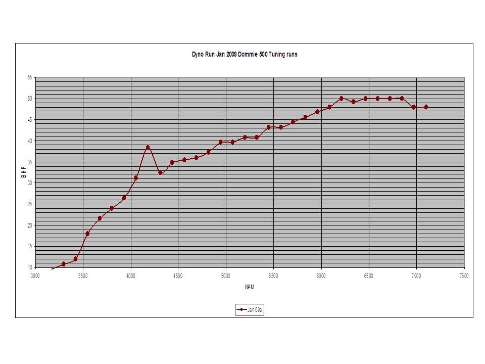

We can't compare dyno power but we can compare the power curves.
This is the graph from a few days ago seen in my "Dyno" post.
9 inch total intake length from carb throat to intake valve, no velocity stacks,the mentioned TT pipes. This is a very wide power range up to 7250 rpm with no dips and 90 percent of maximum torque available from 4800-6800 rpm. the lesser power lines on the graph were with velocity stacks or a 1/4 inch bolt "restriction" in the exhaust pipe exit and jetting trials.
The dyno operator felt a two into one collector can get the power up a bit higher at 7000 plus RPM..
And this is the exhaust on Tim's very successful racer.Different breed of Triumph than mine...but...

Sorry to go back to it.. but your charts do not reflect any fuel mixture readings.. If you are not equalizing the mixture for each set up, you may be pe**** in the wind. On some bikes, one main jet size is worth most of one H.P. And I have found changes to either the intake or exhaust often changes the mixture several main jet sizes.. your comparisons may not be any good if those changes are not accounted for. For instance I made one intake change and the main jet went from a 225 to a 205. At first we thought we lost power.. after re-jetting there was a few tenths more. The basic rule is to make one change at a time, and maximize each change to get a proper comparison.

I have other charts with A/F ratios, 12.9 was best.The best power curve was checked with by A/F and then jet substitution. 220 main was best,substituting a 210 or 230 was almost 2 hp loss at 1700 air density.

I'm familiar with X pipes from car experience.
What Phantom 309 (Tim) describes on his bike was the system I made in a hurry for the first dyno testing. 29 inch 1-1/2 primaries and a 3 inch diameter 17 inch long non tapered common collector. This made two HP less on the dyno than the later dyno test with the 1-1/2 inch TT pipes.In all fairness the bike had a battery failure, no spare battery so the testing was cut short. I should have refined the two into one pipes but....Guys were telling me the primaries were too short,the collector too short so I fabricated the TT pipes.
Looking at the power curve graph above you can see my bike with the TT type pipes has a nice power curve with 90 percent of maximum torque available from 5000- 6800 rpm. It's more like a stock 650 Bonneville with 12 percent more HP that peaks 3000 rpm higher. In reality the engine is just a Bonnie with a bit more compression and cam and large carburetors. I might be looking for more power that simply isn't there considering the present state of tune....
