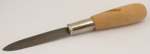

This is the kind I have. Got it from Snap-on. It's called a three corner bearing scraper. One of the most handy tools I own.

One of the first tools we made in school. We would take old three corner files and grind the sides concave to produce three cutting edges. Two things to remember is to make sure the grinder's tool steady rest is right up to the wheel with no gap between it and the stone and not to over heat the metal. You should never let the metal get hot enough to show ANY signs of discoloration, even light straw. Keep water handy to cool the file as you grind. I have these made from swiss files right up through 12" versions. Like Bill said, one of the handiest tools in the box.

When I started as an equipment mechanic my boss had a scraper made from a file. I had to make one. Pretty much did as John said. I still have it today and it holds its edge better than the store bought ones I have.
I don't think you'll have a problem after removing those ridges. But if there's a tiny bit of looseness, a very small smear of loctite bearing retainer will ensure it doesn't move around.

Bearing scrapers are available at good engineering supply stores. Try it--very careful strokes applying quite a lot of force and small movement and the surplus material will come off. It is only an aluminum alloy so is pretty soft.
