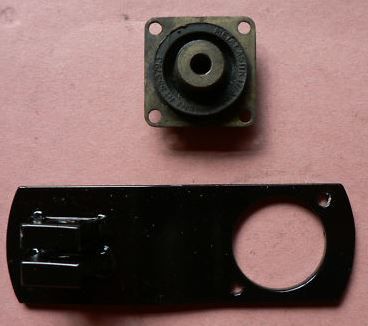

Thanks for the replies and sorry for not being complete in my question! Iím interested in the early unit Thruxtons. Iím building a replica around a í64 T120 carcass.
Plan to use a matchbox remote float and there seems to be a special bracket that it (or maybe the round type float?) hangs from. None of the reference pics Iíve collected show this very well, since itís kind of tucked-up and out-of-sight. I found this image claiming to be the bracket, but not sure if it was what supplied. Also not sure about the mounting.
Anyone familiar with this?

This is what the 1960 bracket looks like.

A side view of that bracket (in the photo supplied by RGS Bob) would be helpful.
The bracket appears to have a downward bend in it, and if it mounts where I think it does, the bend would be necessary for the flexible mount to clear the lower of the two top frame tubes.

That's the only photo I have unfortunately. Looks to be an easy fabrication, but not sure if it is what the factory designed for the unit Thruxton bikes.

It looks like an easy fabrication, as you say, but it would be helpful to know WHERE, and HOW,
it is mounted.
