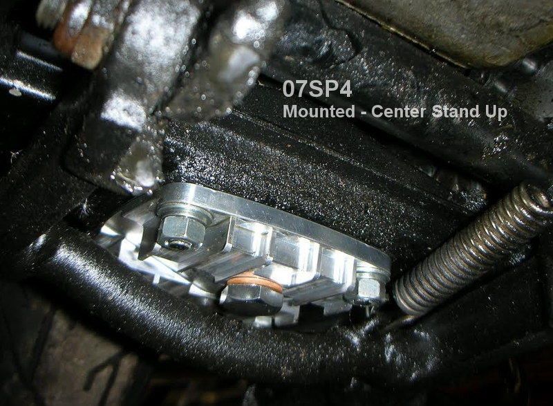

My '78 center stand cross brace hit directly on the Charlie's filter cap nut.
Just heated it up and hammered in an indent just sufficient to clearance.
Didn't want the end hooks of the stand hanging down any lower than necessary- learned the hard way on that situation.
Chopped the grappling hooks off with a Sawzall, tough hardened material took a while but worth it!
Not my bike but you can see the potential for hazard here:
