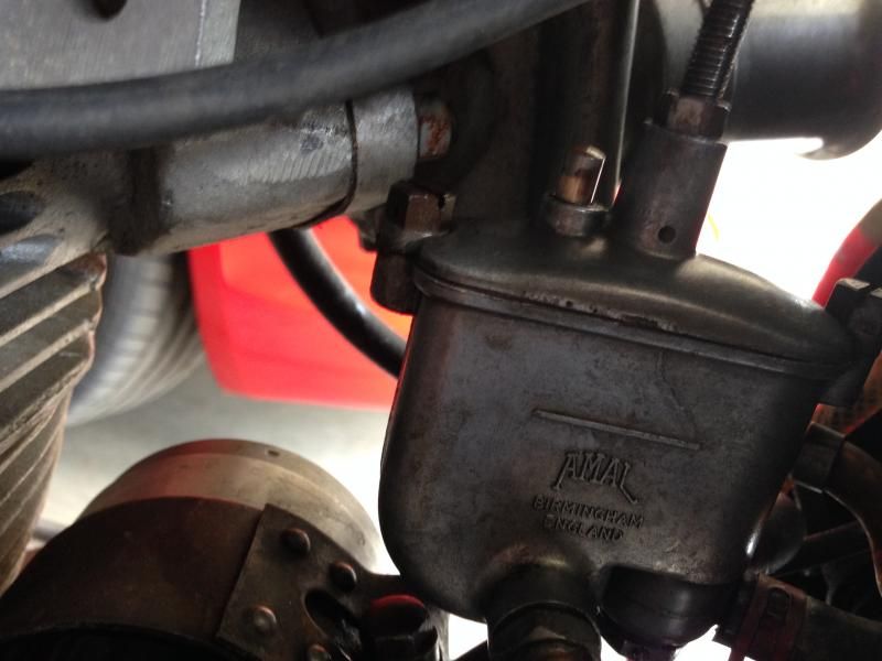

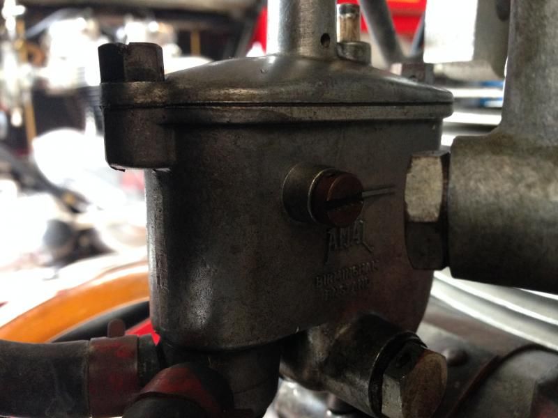

Here are two photos of the float and carb, one from port one from starboard side. I cannot be certain, but it looks to me like the line on the float bowl needs to come down quite a ways to be at the bottom of that bolt/plug on the inboard/port side of the carburetor.
If KerryW and DBDBrian are right, the float bowl would need to come down about to three eights of an inch. If it were lowered, would that tend to lean things out, right? It doesn't maybe look like it, but that line on the outside of the float bowl is about centered up with the bolt/plug on the inboard of the carburetor.
I am sorely tempted to drop the float chamber. Reason is, that whenever I adjust that knurled knob, diametrically opposed to the bolt/plug illustrated in the first photograph, gasoline will come out that knob, which tells me that the fuel level is about even with that orifice. I don't think it is supposed to do that.

Stubbi, to check the level accurately it is best to use a transparent tube on the float chamber outlet, which will indicate the exact level in the chamber, as the level line can't always be relied on.
If fuel is running out of of the bleed hole, under the fuel metering needle on the knurled adjuster, it would indicate the level is to high, assuming the float valve is not leaking.
