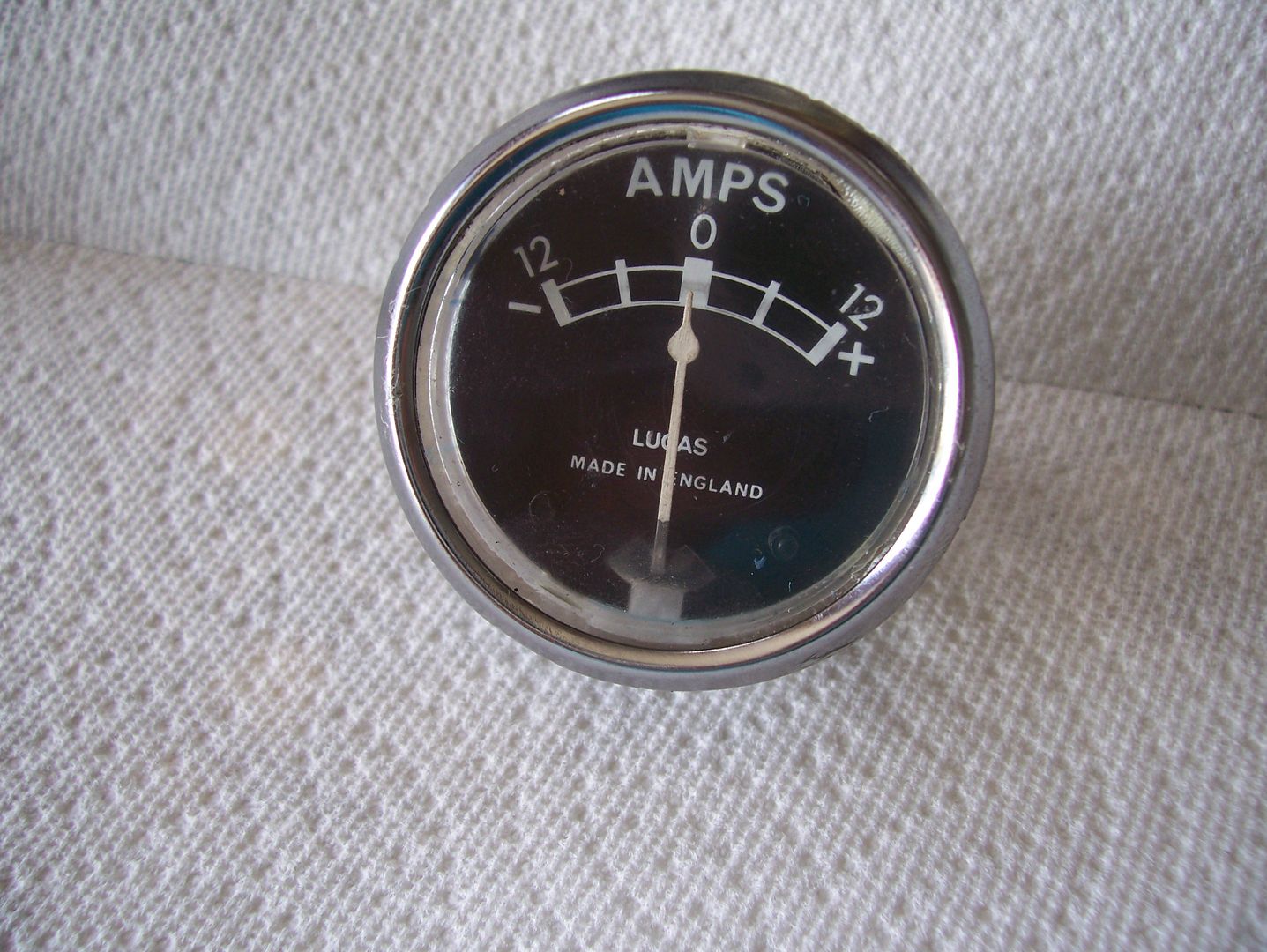

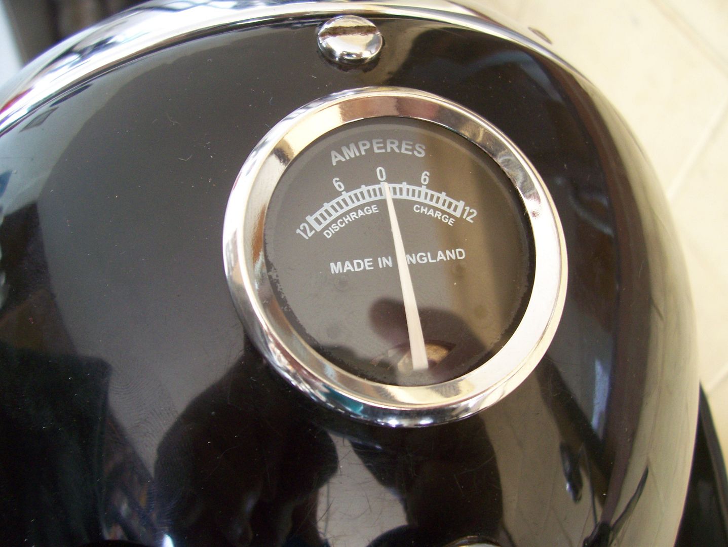

Just a note to mention how you might get some more miles out of the Lucas ammeter.
I bought one of these from one of the Indian suppliers and installed it.
We'll see how durable it is. Price was right. A bit lower than the Lucas repro out there. I like the operation of it. It seems a bit more sensitive and smooth without the wiggles of the Lucas unit.

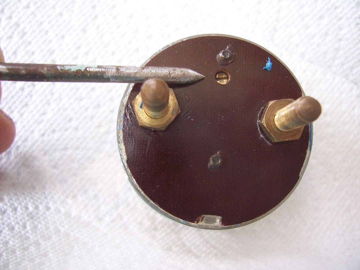

So, before I chucked the old one in the can I thought I'd salvage any brass hardware off it. Waste not, etc.
Just for grins I thought I'd pop off the back and see why it died. The needle had fallen off and was bouncing around inside. I'm sure you all have seen that happen.
The phenolic back popped off by inserting a small screwdriver between the body and the back and it came off in one piece.
Then I began to look closer.
This little screw is what traps the needle in place. Magnetism is what centers the needle. No springs or anything else in the meter.
Then with steady hands and straining my low-definition eyeballs, I managed to trap the needle back in position. Wham bam, hot damn. Just like new. Or close enough, anyway.
I glued the phenolic back on the body with Gorilla glue.
I wonder how many of these I've thrown away over the years when ten or twenty minutes worth of work I could have repaired it.
Live and learn.

I can't believe they spelled discharge wrong!
Ed
1970 Bonneville
Re: Repair your ammeter [Re: HawaiianTiger] #542248
05/09/14 12:56 pm
05/09/14 12:56 pm
Joined: Feb 2014
Posts: 935
Lancaster, California
C.B.S Online content
C.B.S  Online Content
Joined: Feb 2014
Posts: 935
LOL! They sure did!
Re: Repair your ammeter [Re: enigmaT120] #542258
05/09/14 2:10 pm
05/09/14 2:10 pm
Posts: 5,557
HawaiianTiger Online content OP
HawaiianTiger  Online Content OP
Posts: 5,557
laughing laughing laughing
I surprised it doesn't say "Made in Englnad"
Is there a town in India named England?
I've heard there is a town in Japan called Usa.

Did exactly the same repair about 2 months ago on one of mine. I found the pointy bits that the plastic needle sits in the 'bearings with were quite worn. I once stuffed one thinking that screw was a 'centralising' screw like you see on electronic instruments. Unscrewed it an the needle fello out of its 'bearings' Haha, stupid me in a fit of frustration chucked it out without thinking I could have fixed it. In my fiddling I worked out you can use that screw like a damper to stop those wild swings. That happens when the needle is loose in the 'bearings'.
Turn your lights on and off and you will find with slight adjustments of that you can slow down the needle swing to the point where it moves smoothly in a nicely damped manner. I think these wear and regularly tweaking the screw a little bit might stop the needle popping out which seems to be the common failure with these.

Thanks for the post Bill
it turned out to be very helpful
yesterday I took my Bonneville out for a spin
and saw my amp meter was moving UP AND DOWN!
(it didn't work before, but it never did that)
so today I took it out (it had come apart)
and I fixed the needle, which was the same as yours
and glued the thing back together, and it works GREAT!
I now have a working amp gauge, thanks again
