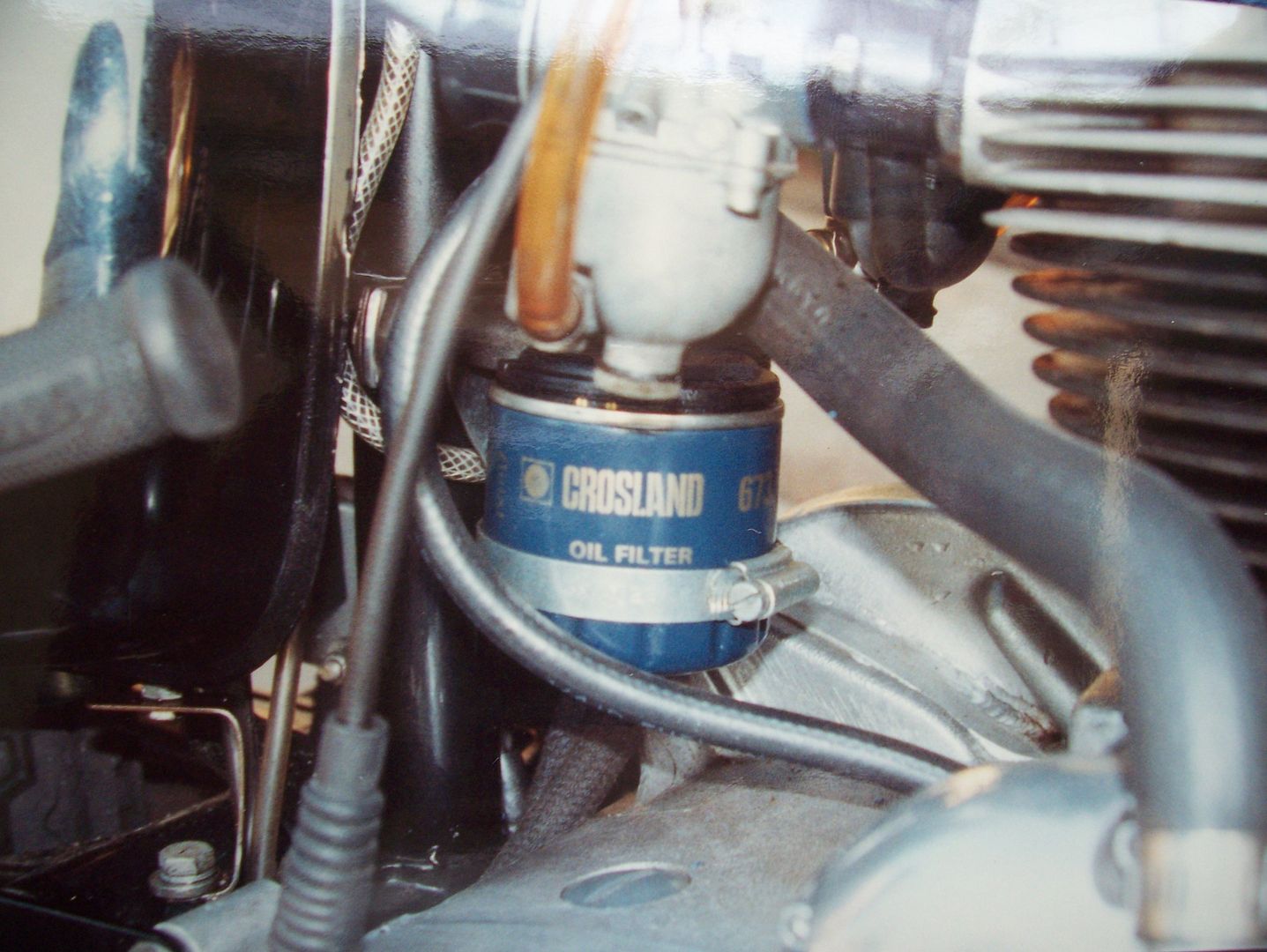

Here's where I put mine
Been there for a couple of years and I'm happy with it. I sometimes get the urge to go slightly of road and on dirtroads and I like that it is protected from rocks and whatever.
Would of course look better had it been hidden away somewhere.
I mounted it using some clamp that I found at the hardware store.
