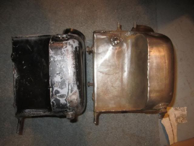

Mark
As far as I can see the L tanks are all the same size. Below is a shot a an M20 tank on the left and a GS tank on the right. Only the camera angle makes them look different.
As Ponyboy mentions above there are the attachment points on the top (mine have bolts welded into the threaded holes?) and the mystery threaded hole on the back where it wraps around the fender.
These tanks are really poorly designed as the feed goes from a plain hole in the bottom and the oil is sort of filtered coming back into the tank. I read somewhere that in one of the ISDT events the return filter caused engine failures.

Thanks Pony and Gordo. So other than the extra attachment points on the top of the tank does it attach to the frame in the same manner as the small round B31 tank?

Mark: Yes it just bolts to the back of the battery holder but I think the front bottom hole is in a slightly different place. The B31 tank has threaded tubes to allow it to reach the mounting plate where as the GS tank goes right against the plate.
