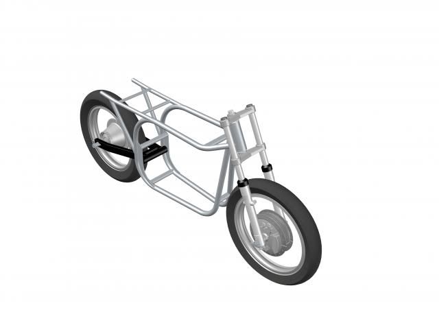

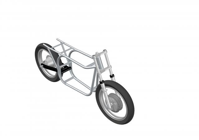

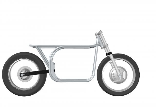

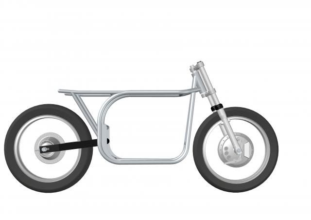

…where I am ready to build the wheels. I am using a Norton Dominator 8” front hub with a Commando TLS brake and a rear Triumph conical hub and brake assembly. I have been considering the options for rim and tyre sizes, what seemed like a pretty straight forward decision is proving to be a bit more difficult. I have now narrowed it down to three possible options all using a Morad flanged alloy rim and Avon AM26 (Roadrider) tyres, as follows;
- Front 19” WM2 rim with 90/90-19 tyre / Rear 19” WM3 rim with 100/90-19 tyre
- Front 19” WM2 rim with 90/90-19 tyre / Rear 19” WM2 rim with 100/90-19 tyre
- Front 19” WM2 rim with 90/90-19 tyre / Rear 18” WM3 rim with 4.00-18 tyre
I would be greatful for any advice and opinions on this based on experience and the affect on handling with different wheel and tyre sizes when used with a featherbed frame. Aesthetics are also important as I want this to have the look of an authentic period café racer.
I have drawn out to scale the three configurations I have in mind to get a basic idea of what each will look like.

18" wheels front and rear would give you a better choice of tyre sizes and tyre choices ?
And equal size wheels front and rear, as was done and recommended, for featherbeds.
Conical rear wheels came as 18", and 18" was stock on some featherbeds, fronts as well of course, so its not as though you are going into unknown territory.
And the rolling diameter is not too different either.
As long as you have the 7 & 3/8" fork centres, to allow a slightly wider front tyre with no clearance/fit problems.
Hopethishelps.

I am using the 3.25x19 + 4.00x18 on my A65, you do not want to fit a 4.00x18 to a WM2 rim! it is a wide tyre and a tall tyre at that (much taller than the K70) The spec sheet reccomends a WM4 rim but says a wm3 will fit (and it does)
If you use a low profile at the front or a semi low profile. a big fat tyre on the back won't look right IMO,
My personal choice would be using both 19" WM2 rims front and rear. The tyre combo is similar to that used on an A10 - which IMO is one of the best handling bikes I have ridden. + a similar size difference to my Honda which again handles far easier (and can corner sharper) since using tyres and rims of a similar size
Here is the Avon spec sheet http://www.avon-tyres.co.uk/sites/default/files/product-specs/Roadrider%20pdf%20datasheet.pdf
Remember that the MT** isn't a WM** size and is the width of the rim (this old post should help)
http://www.britbike.com/forums/ubbthreads.php?ubb=showflat&Number=226487

. Unless you particularly want the 'fat-back-tyre' look, I'd rule out the 4.00x18 rear; even if you do want that look, maybe consider the 110/90x18 instead?
. If you do go with a 4.00x18 rear, consider the wider contemporary experience and fit the 3.25x19 front? The 90/90 front only has a similar overall width to the 3.25, while having a substantially-smaller (in tyre terms) overall diameter.
. If you aren't particularly concerned about said look, consider the sizes most Featherbeds were fitted with originally. Afaict, that would've been 3.50 rear and 3.00 front, either on 18" or 19" rims. The overall height of the 100/90 is still pretty close to that of the old 3.50 (albeit the overall width is greater) and, while the overall dimensions of the 90/90 are 'less similar' to a 3.00, the 100/90 rear / 90/90 front has been a common o.e. combination for decades.
. Consider the tyre makers' recommended rim widths, rather than 2.15 (WM3) rear and 1.85 (WM2) front. Even when I first started talking to the technical guys at Avon and Dunlop back at the beginning of the 1980's, they were saying that all the tyre makers reckoned that all the bike makers - British and Japanese, Italian and German - fitted too-narrow rims for the tyre widths.
Like the drawings; bigt what did you do 'em on?

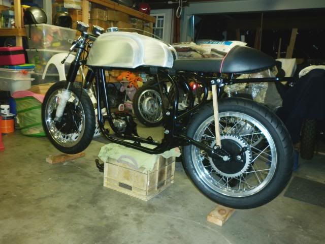

I've set my Atlas up with 18" front and rear. A bit along the lines of Rohan's suggestions earlier. And basically because that was my personal preference for what I am trying to achieve. Not based on any secret information about how superior this is for some application in particular.
Just installed a 100/90 Avon roadrider on the back and got the wheel in over the weekend.
There was lots of to-ing and fro-ing at the tyre shop, but I'd done my looking around and reading and figured I'd want a 100/90. The 110/90 was just pulled out for comparison. Tyre shop was quite convinced I'd really want the 110/90. I guess in part due to the obsession with fat tyres.
Pretty snug fit in the swing arm with only maybe 1/2" on each side.
Tyre shop was going on about the WM3 being too wide for the 100/90 and I'd need the 110/90. WM3 is the minimum width recommended for the 100/90 as you'll see if you check the sheet Alan linked to.
Looks 'right' when fitted up to the rim (valanced with Tri conical hub). Also when fitted to the bike (although really more than a frame at this stage)
Has been said that that larger profiles slow down the steering a bit (not a reason for 'skinnies' for me). Maybe this is what Wilfred refers to. Even these skinnies (which is what the tyre guy called them - in a half patronising way) would have a shed-load more grip than tyres of the sixties. Certainly in smaller capacity classic racing some guys I have talked to say they want to use the skinniest tyres they can get away with that have sufficient grip.
I'd have a 90/90 on the front except the Australian distributor was out of stock (apparently).
For me this is correct combination. But again, that's based on my bias and opinion, nothing else. This is for the Avon. Try it with a Bridgestone and the 90/90 will look like it's part way to a bicycle tyre. Sizes differ for manufacturer's.

Hi Stuart, thanks for the advice, I have ruled out the “fat-back-tyre” look for this bike and have decided to go with AM26 100/90-19 rear / 90/90-19 front. This is what I am using on my Venom and am quite happy with the look and handling. However, after reading your point on rim widths I went and had a close look at the rear wheel on the Velo which is a WM2 and is below the manufacturer’s minimum recommended rim width for a 100/90 and could see that the side wall angle and contact area profile are a bit steep. This is fine on the Velo as I wanted to restore this as close as possible to original specification, but with modern tyres as I ride it quite a bit. There is of course no such consideration when building a special, so I will go with a WM3 (2.15) on the rear and WM2 (1.85) on the front of the Triton which is in line with the Avon recommended width ranges, be it at the lower end of the range.
The drawings were done in AutoCAD.

Hi Bry,
The only other thing you might want to check is the suspension lengths and travel on the Venom compared with your Triton.
100/90x19 has a relatively large o.d. compared with the more usual 100/90x18 or equivalent rear paired with 90/90 or 'equivalent' front; not a problem on a bigger bike like a Triumph or BSA triple with a greater overall height and obviously not a problem on something like the Venom, but does the latter only have short rear suspension travel?
Nevertheless, your bike, your choice, no argument, just looking forward to pictures of the finished bike. bigt

I have also bought flanged aluminium rims for Norton from Don Pender. Trades as Madass or something similar on eBay. He was in Brisbane, now moved to the Phillipines.
He sells a set of 18"R/19"F. Prices used to be very competitive. I have found the one set I used OK, have heard other experiences though (but that could be professional rivalries coming into play)
BTW, I'm getting my 90/90 18" front fitted in the morning and I will post a pick of the setup when I get the wheel in. You will be able to take a look and see what you think.

Hi Bry,
If still of interest and you havent fitted your's already here is a photo of mine with 90/90 x 18 front and 100/90 x 18 rear. Definitely harder to get a feel for this from the image than from 1st hand viewing.

Hi Ray, looking good thanks for sharing, you're right it's always better to see things in the metal; that front brake/hub set up looks tasty, what is it? Manx?
I ordered 19" WM2/WM3 Morad flanged rims yesterday, should have them next week.
