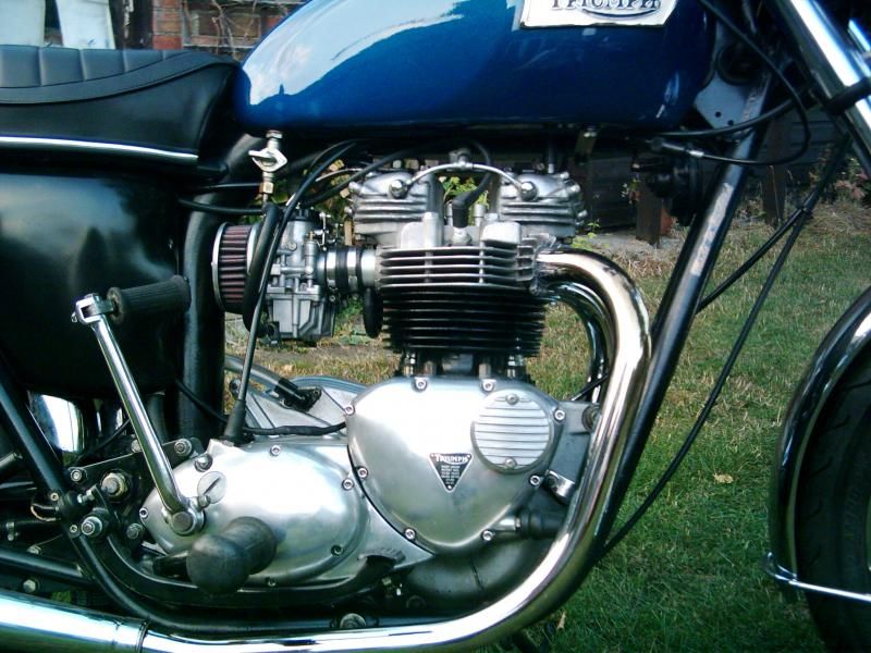

I made an Air Filter assembly a few years back. Didn't work too well at the time as it strangled performance and the carbs drooped. This year I turned down and radiased the rear stubs to create a more favourable angle for the air coming in from 90 degrees. Whereas the Concentric MKI seems to be designed with pancake type filters in mind the inlet stubs on the MKII's seem to be designed for airflow entering from the rear only IMHO. Plus made a bracket to support it attaching to the head steady mount on the frame above, if not the carbs sag on their rubber mountings. Seems to work fine now:

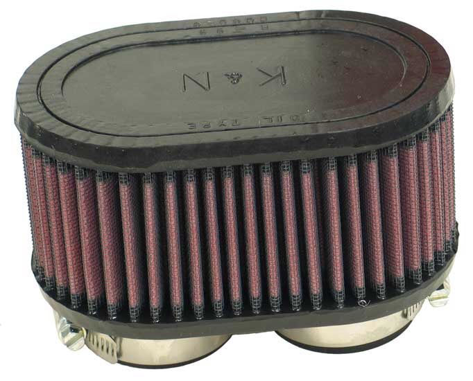

Do you have room for this?
http://www.knfilters.com/search/product.aspx?prod=r-0990
Part R-0990 Product Specifications
Product Style: Dual Flange Oval Universal Air Filter
Flange Center to Center: 2.625 in (67 mm)
Flange Inside Diameter: 1.875 in (48 mm)
Flange Length: 0.625 in (16 mm)
Flange Type: Offset
Height: 3 in (76 mm)
Outside Length: 6.125 in (156 mm)
Outside Width: 3.875 in (98 mm)
Top Style: Rubber
Top Material/Finish: None
Air Filter Shape: Oval
Filter Material: Cotton Gauze
Flanges: 2
Base Outside Length: 6.125 in (156 mm)
Base Outside Width: 3.875 in (98 mm)
Filter Re-Oiling Amount: 0.57 oz (17 ml)
Flange Offset: 0.375 in (10 mm)
Footnote 1: Base Has 13/64" Vent
Top Outside Length: 6.125 in (156 mm)
Top Outside Width: 3.875 in (98 mm)
Weight: 1 lb (0.5 kg)
Product Box Length: 4.63 in (117 mm)
Product Box Width: 4.63 in (117 mm)
Product Box Height: 7.25 in (184 mm)
K&N R-0990
