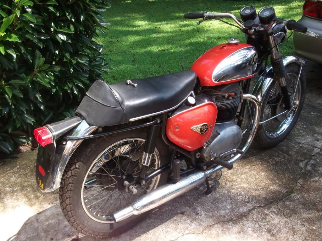

A little cleaning and some sunshine:
OOoOooOooOooOOgh!

Sweet!!!!
IMO (for what ever that is worth), other than the seat, that is a fine example of a 1964 east coast LR. I would say tail light and tail light fairing is correct for that bike
Nice find, I am jealous!

They're still out there! Or in this case, in there. That's encouraging. That's a nice find.

I have a 1965 LR and it has the 679 taillight with an adapter between the taillight bracket and actual taillight..And yes, as stated it's hard to tell what they came with from the factory..Don't know if these pics will help you, but here they are just in case...I may have a similar bracket with the 564 light if you would need a pic...

That is a beautiful bike. I'm tempted to try and make my 1970 Firebird look somewhat similar.
OOoOooOooOooOOgh!
