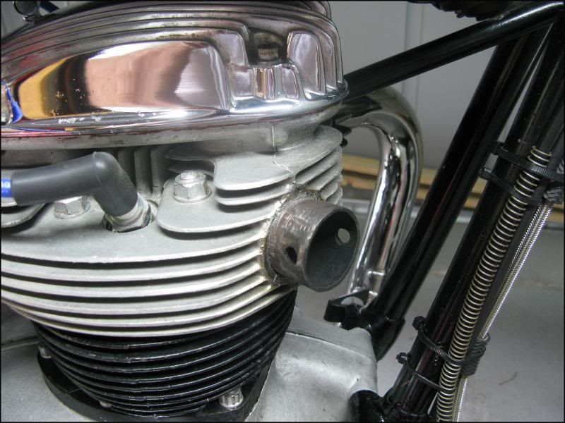

Re: A65 Exhaust mounting [Re: Patch] #502357
08/18/13 10:56 pm
08/18/13 10:56 pm
Posts: 255
Oahu Hawaii USA
Roger Gulledge Offline
Posts: 255
Oahu Hawaii USA
I too have wondered about this.
I have been wanting to put simiese pipes (2 into 1) on my A65 for a while now but can only find them in 1 1/2"
The problem being somewhere along the line 1 3/4" pipes were put on the bike. this how they did it.
If I am not mistaken this is the setup that Triumph used,
My question being, is there a way to go back to 1 1/2", can the ports be filled with some sort of weld and machined back to 1 1/2"?
Have been looking at maybe getting a used head.
Roger G

Re: A65 Exhaust mounting [Re: Roger Gulledge] #502365
08/18/13 11:36 pm
08/18/13 11:36 pm
Posts: 2,951
Posts: 2,951
Roger,
I believe some turnips had pipes with swage open ended pipes? The end fit over those steel sleeves, but quickly returned to 1-1/2" diameter? I think I have an old set, that somehow came into my collection of unusable parts... Even still have the finned clamps on 'em...
Maybe you might try to see if'n a set of turnip siamese pipes might be made to fit???
Another thought: maybe try to contact one of the pipe makers { NOT ARMOURS!!! }, and see if'n they might tackle a one-off set, with a swage ended set of head pipes, to fit your sleaves? Fekked? Overlanders? Anyone else???
Maybe remove those turnip inserts, after marking where they actually start coming out of the port, then having a machinist make a set of inserts to fit 1-1/2" pipes?
Or, yeah, find another head, or have yours welded back closed and re-machined to shape... Make certain SURE all the carbon is removed from the port first... Aluminum doesn't like ANYTHING foreign polluting a weld...

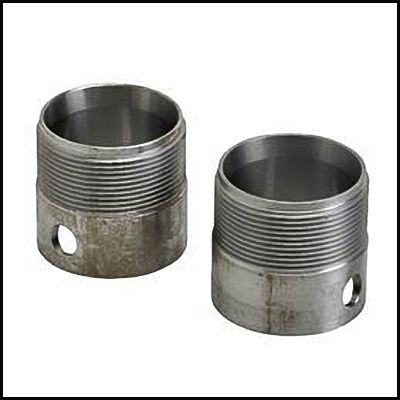

Re: A65 Exhaust mounting [Re: Patch] #502366
08/18/13 11:47 pm
08/18/13 11:47 pm
Posts: 3,876
ca, us
DMadigan Offline
DMadigan  Offline
Posts: 3,876
ca, us
Triples use those spickots with 1-1/2" pipes at the head (neck down to 1-3/8" afterward). 1-3/4" pipes are too big. Popular with the "TT" look alike crowd. What is the diameter of the spickots in your head? I make these for the triple (1-1/2" pipes):
The short tapered piece is welded to the pipe. The spin ring pulls/pushes the pipe on/off the head so you do not bend the pipes with a mallet. Stainless/7075 aluminum construction.
