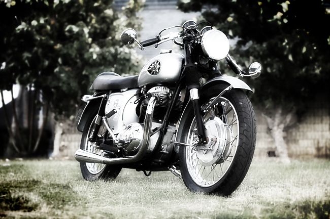

Was going to post this on the Clubman thread but see it is locked, so here goes.
I am in the process of getting ready install rear sets to my 70 A65 and have been working with a few members here for drawings and info on the clubman rear sets. I have most of what I need, (NOS rear set brackets, the hangers, foot pegs,the hanger studs) what I am not sure of is the break pedal. There have been different ideas out there such as a C15 pedal that would require some tweaking. I found this on eBay uk BSA Goldstar Clubman Break Pedal
Would this be the way to go even if I had to tweak it a bit?
I know you kids like pictures....So here is what they will be going on.

Yesh we like pictures! Lovely that one: Bridgestone S11's and some kind of weird fairing on the front of the side covers but I likeee.
We request more pictures of your rear-set set-up after the install...
...yesh yesh!

Well after a long haul I finally got my rear sets on. Would like to thank Rich B and rbt1548 for their help with drawings and info. Rich that tip on the BSA P/N 68-6035 break pedal was the icing on the cake. I got the last NOS they had from Rabers. The foot peg brackets I found on eBay England.
The biggest problem I had with the project was finding a machine shop to make the other parts. There were plenty of small shops around years ago that one could get things machined at a reasonable price. Now they are all gone and I was left with 3 or 4 large shops that do large commercial work. Took the drawings to two of the shops and just about fell over when they quoted me a price. First shop wanted $1,900 for the ten pieces I needed. The second one wanted $1,700. I started looking around for friends of friends that might do it and found the first guy. After 3 weeks of saying he could do it for $700 he passed on it and gave me a name of a friend of his that would do it for $800. Still a lot for the amount of work, but I was already into this with the other parts and I realy wanted rear sets on the bike. He took almost 4 weeks to finish them because he was doing it as a side job. He did most of the work on a CNC machine. He works for a small company that builds parts for satellite cameras and other instruments going into space. Not the machine shop of old. Looked more like a hospital operating room.
I must say I am very happy with them. I have ace bars on the bike and with the stock pegs it was never that comfortable leaning forward. My legs were to cramped, now they are stretched out and much more comfortable. Was not sure how I would like the reversed shift pattern but I now like it better than stock.
Couple of pics. of the rear set parts and such.
Again a big thanks to all for the help.

That really looks the business! some nice machinery work gone on there and a big thank you for all the pictures.
Just a note in the last picture, it looks like your silencer bracket is fixed to the rear shock mount on the swing arm? if so, something is going to break (apologies if I have not seen this correctly).
Also how do you find the bike with the extra length on the exhaust pipes? when I added the kick ups only, I found it brought the torque peak down by about 1500 rpm, it gave more power in the lower sector.

The peg set up looks great but the whole bike is fantastic, good on ya

Looks awesome! I've contemplated doing this to my cafe Lightning,but I wasnt sure what was required. Someone needs to start making these kits, and making them available.
Again, great looking ride!

Your bike looks amazing. It literally took me 5 minutes to find that rear brake pedal in that picture! ha ha!! I love how clean the brake assembly looks.
