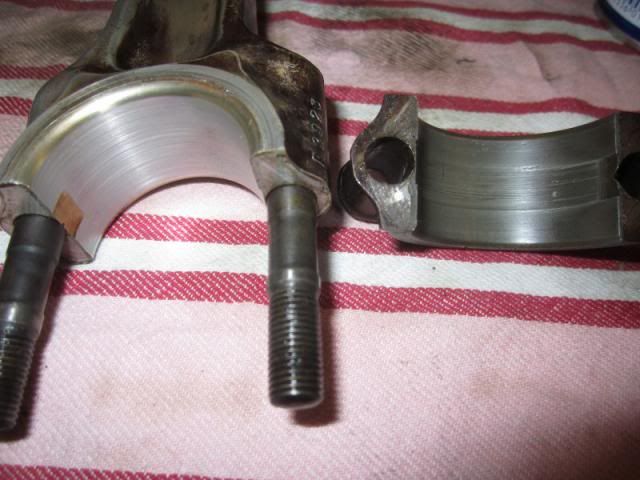

I now have my 1953 5t engine apart and I expected some sort of babbitt bearing arrangement based on the references I have. As far as I can see this engine has never been apart before so it is most likely as it left the factory.
About 20 years ago I talked to the original owner about whether or not he had ever upgraded the conrods to the later style with bearing shells but at his age he could not remember what had been done, if anything. I have no experience with babbitt bearings.
What I find is an alloy rod with steel cap as below. What I find strange is that the rod and caps look so different on the inside. The rod looks like it was running straight on the journal. I am not sure what the cap looks like but it is more like what a used shell might look.
Is this what used babbitt bearings should look like after some 60,000 miles?

What's the crankpin size?If it's 1-7/6",the rod will be white-metalled.
If it's 1-5/8",the rod might not be white-metalled.The first year or so of big journal cranks had no white metal in the rod;only the cap was white-metalled.
'53 would have originally had the small journal crank.

Pete: Thanks for the info. The journal appears to be 1 7/16 and the rod seems to be plain. Does that make sense?
The surfaces look so different when I compare the rod and the cap.
Is it possible to babbitt an alloy rod? I talked to a local old car restorer and he thought you would need a steel rod for the babbitt material to stick.
I suppose the real problem would be finding someone who could do a babbitt job for me if the originals are too far gone.

Gordo, If I'm not mistaken, the rod runs on the aluminum of the rod itself. The rod cap is the only thing that is babbited. Dick

kommando  Offline
Posts: 9,499
Briggs and Stratton all alloy rods run directly on the journal, the alloy is a good bearing material. When making Babbit shell bearing strip at the Glacier factory the hot steel was tinned in a hot liquid bath of 100% Tin before the molten Babbit was poured onto the steel.

Dick: I think that is what I have, the plain alloy rod with the steel babbitted cap.
Brian: Thanks for the link. I have emailed them to see if those rods will work with my small journal crank. A bit pricey but maybe a lot more straight forward.
My fear has alway been that I would throw a rod through the cases if I rode the bike too hard. It is a very original unrestored machine and I would hate to destroy the engine. I had an exciting 70 mph lock up some years ago so I fiqured it was time to give it some TLC to prevent disaster.

SRM replied that their new rods will work with my engine. They are not cheap but appear to come with the bolts.
It sounds like the original rods cannot be used if the crank is ground to undersize as the alloy rod cannot be made to fit the smaller journal even if the steel cap can be resurfaced to fit.

It's my understanding that the 1953 5T was the long-stroke 500 and used the same rods as the 650. Now the 650 rod never changed length, so you have the option of finding 2 nice used matching 650 rods and using those.
Remember, when you change the rods, you'll also need to have the crank re-balanced. So save some money for that.
