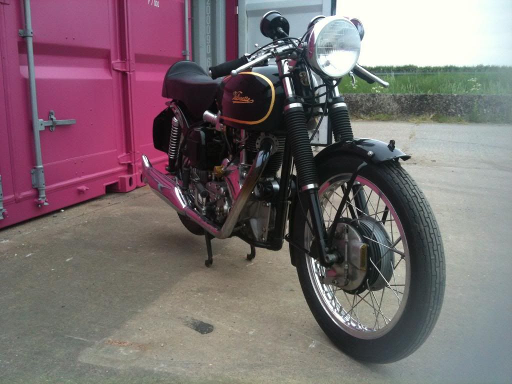

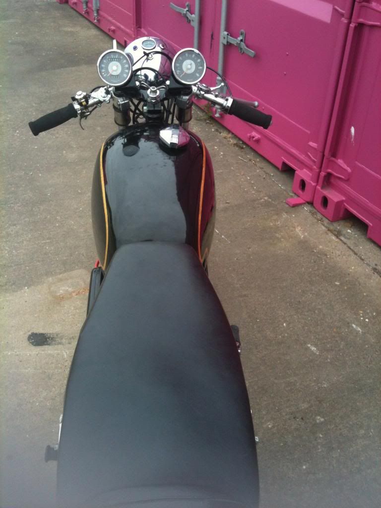

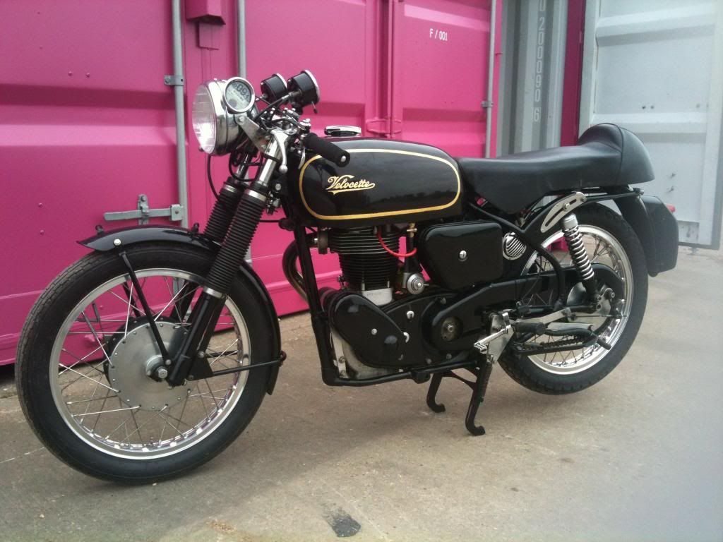

Took delivery of my bike on Saturday. It seems very straight and original, having never been restored, from the look of it. It needs a bit of a clean, though there's little (if anything) that it needs.
Paid a little xtra and took the option of the MkII Concentric carb and new inlet, plus the spare tank and seat the previous owner had stock-piled for the bike.
Have had it running: it's mechanically quite quiet, pumps nice clean oil around and all the electricks work. Yet to ride it though. back in the UK for holiday for 3 weeks at the end of the month, so will swing a leg over it then..
Presumably original matchbox float fitted for the GP (can't see there'd be room for any other float chamber), though how they expected the common owner to tickle the float I don't know..
Couple of pic's:

Beautiful bike!
What production year is your bike?
Do the Thruxton bikes have an engine number that is unique to this model like the VM for Venom bikes?
