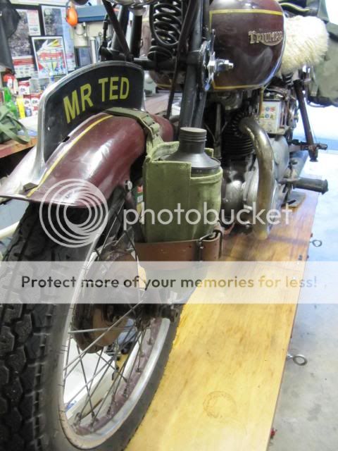

Well over due for an update.
Have now done in excess of 10,000k and for the most part trouble free or with the one exception all able to be sorted on the side of the road.
The one exception was when the keyway on the alternator rotor broke, rotor sliped and then jamed and started a minute ocilation, all meant every turn the rotor hit the staor as as you all know once that happens it all turns to sh it preety quick.
Reading a Brit vintage mag couple of months ago and spied a photo of some obscure European classic war motorcycle taken at a French rally.
Had a 2 gallon (thats Imerial gallon) petrol can mounted on the front forks.
Got me to thinking with the result..............
1943 British Army amo pouch with the flap lid cut off.
Double buckle French Army officers leather belt.
Brit army webing to tie the top in
Post war Castrol Wakefield 1 quart oil bottle
Have filled it with Castrol 20W/50 Dinasour juice, stragely, well maybe not so strange as this old bugger is a bunch of miss matched parts all cobled together, the xtra weight tends to steady the front end a bit.

Has to be said that getting rotor to stator clearance right is tricky on early Triumphs and lack of clearance could loosen the rotor and break the key
If what you think happened is what really happened, there must have been a failure of the nut, washer, whatever, to clamp the rotor, for some reason. It would be good to find the reason. Otherwise it will probably happen again. Sounds like the nut might have been tightening up against something other than the rotor.
I reckon hanging stuff on the unsprung, steering part of the suspension has disadvantages. A Speed Twin is fast enough to get into a speed wobble and kill you.

Triton,
As you say these early alternator motors with the Stator mounted on the outer primary case are a real sh it to set up.
Few things happened here to lead to the key breaking.
Clearance, although OK when I put it together at 3thou on one side and 8 on the other with the locator dowel missing from the outer case it was a gamble.
Also looking at the innerface of the mainshaft sproket it was not bedded correct.
When the stator and rotor came together it off course generated heat and eventualy all the resin, oil etc heated up.
This coloured all exposed metal faces hence I know there was a face problem between the sproket and mainshaft oil seal. End float would have done the rest.
Have made up a dowl and turned down the rotor so I have about 11 thou clearance all round.
Handling is suprisngly good with the oil bottle.
Gave this a lot of thought before I put it together and figured that if most military models could ride around with a 20ld gun sitting in a leather sheaf strapped to the front forks I should be ok with 2ld of oil.
trev
