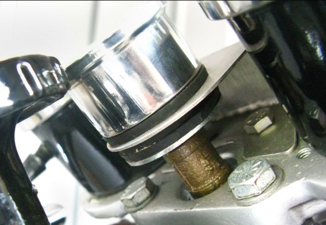

Adam...I did not block off the stock breather. Intake is at front of case and exhaust is from top of valve cover. Performance wise I think it pulls harder in mid and high range,and oil stays cleaner longer. The yellowish color of new oil stays yellow longer, doesn't darken as quickly. Don't know if that translates to cleaner. smile
The gauge I used was a Stainless Steel-Case Liquid-Filled from McMaster-Carr. McMaster-Carr Type in 3850K3 in the search. Quite happy with it so far, about 3,000 miles. I have a SRM oil pump installed, hot idle is 14-20 and 60 at high revs. The liquid-filled is the way to go, needle is rock solid.
Leon...You are correct,tried to isolate vibration with rubber grommets .
Roger G

Roger - Your bracket results in a higher position relative to the smiths clocks than my piece of scrap. I will try to copy yours. but you must have a nicer hacksaw than mine.
