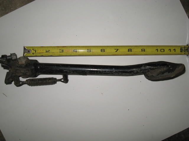

This sidestand is what I believed was used on the late Gold Star's and A10's. It appears to be 12" from the eye of the mount to the tip of the shoe. It's body id oval in shape.
Not either one of my GS parts books show the sidestand. This is a scan of the BSA B31/B33 parts book that shows sidestand #42-4772.
This is a scan of a late A10 parts book that shows sidestand #42-4765.
I think I would go with the 42-4765.

The 60-63 A10 book shows 42-4765. The 58 book shows 42-4772. Like boomer said.
The one on this GS Looks like the 42-4765. I'd imagine either would work just fine though.

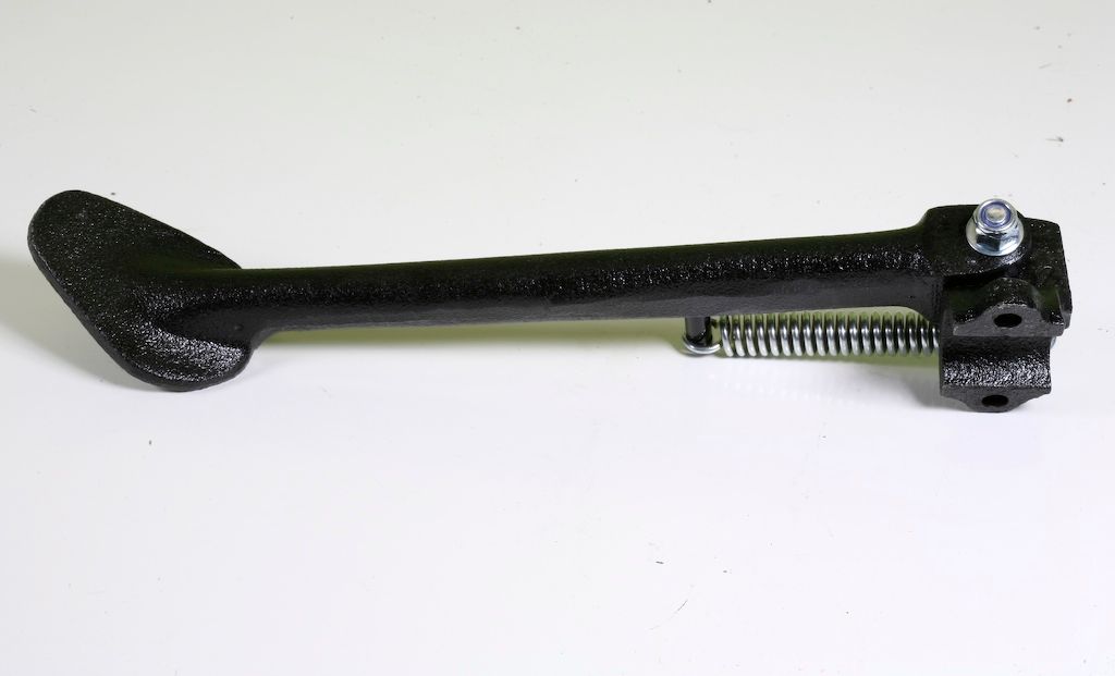

$158 USD delivered from Burton Bike Bits, UK.
Heavy, solid and nice.
