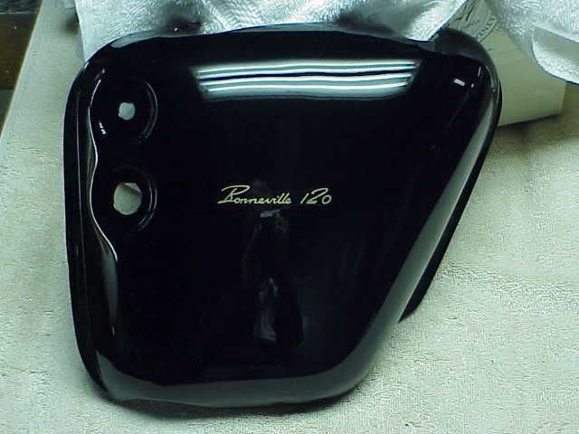

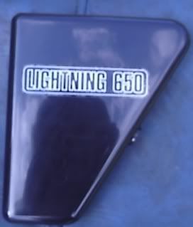

Posts: 5,196
Posts: 5,196
Originally Posted By: LorenzoI
Anyone has a picture to display of the mylar decal applied on a tank or a side panel?
OK, so it's not a Triumph, and it definitely wasn't applied by the factory. But, it is a Mylar decal.

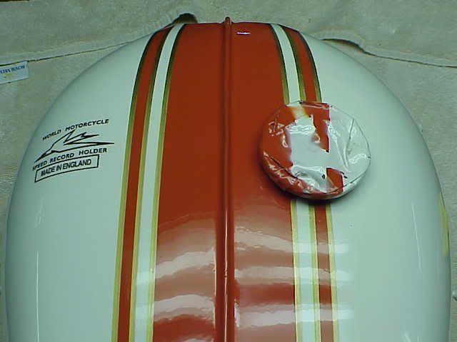

Hi Rob: my painter has having problems with the waterslide decals I provided him. He says that the clearcoat wrinkles them and wants to use mylars.
Can you tell what is the difference between the twos? can you show a picture of the mylar applied on your bike?
Thank you!
Well, you know what waterslide are. They are a type of thin clear material with ink on them that are held on with a water soluable glue. Mylars are just that. They are adhesive backed clear mylar with ink on them.
Sounds like your painter is not dusting them with clear, but rather shooting them like he would a normal clear coat.
Here's my mylars after clear coat.
regards,
Rob
regards,
Rob
