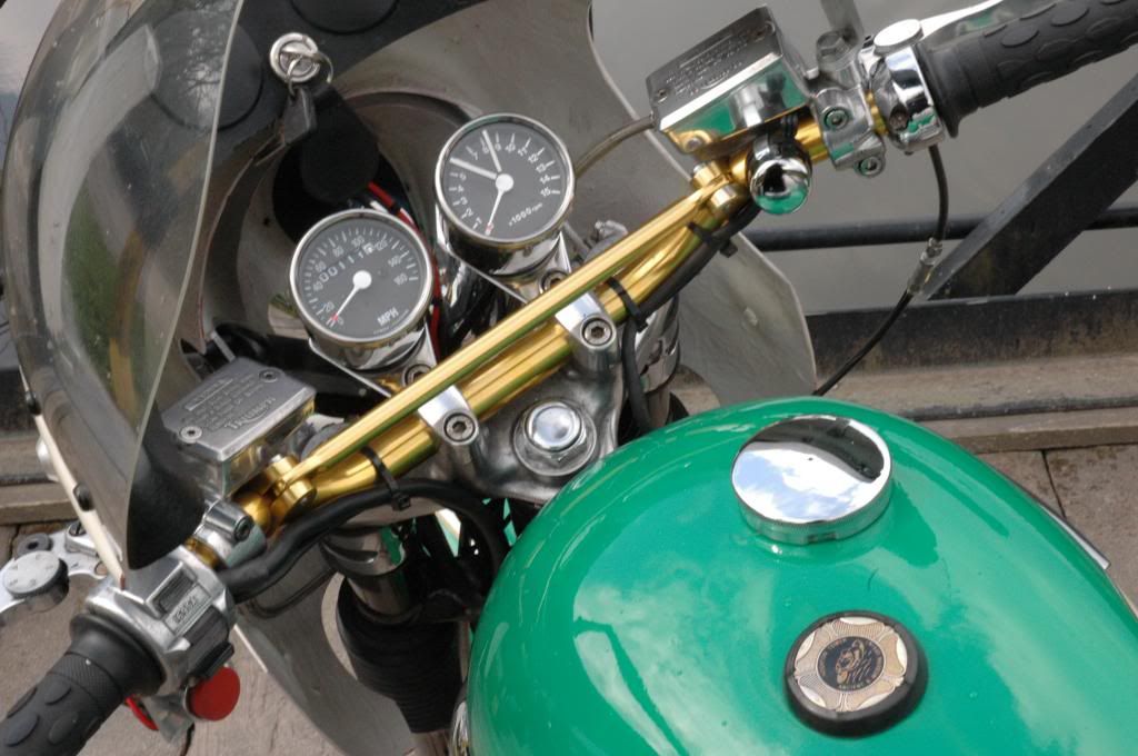

This is an early Speed Triple master cylinder mated to a PSP (aka Les Wiliams) clutch. It worked fine, but I did need to cut off the lever mount on the original Lucas switch.
Photo copyright of Steve Myatt.
