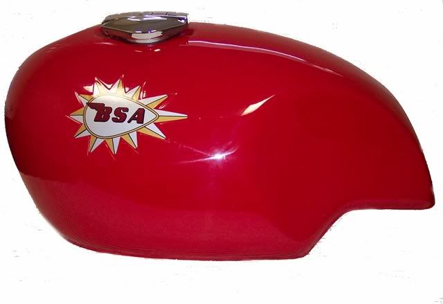

That's a Starfire tank......

Don's right. The eBay tank you posted the link to is the Starfire tank. And no, I haven't seen the large A65 tank like my Blue one at British Only. I've never seen one for sale, other than the one on the bike I had to buy to get mine.
The two most impossible tanks to find seem to be an original Spitfire Home Market tank and the one like my blue one. And at least you can get a reproduction Spit tank from Burtons. Would this one work for you?

So Jim how close is the spitfire tank profile to yours? Is your blue tank the same one in Bacons book that shows the 1970 home market tank? Would a 65 lightning tank work on a 1970?

T Harper sez:
"Would a 65 lightning tank work on a 1970?"
Any dry frame tank will fit any dry frame. Only the rubbers, center bolt, and stabilizer bracket varied.
But one caution, when dealing with the early large home market tank, single and dual carb versions exist. The dual carb can be installed on a single carb bike, but not the other way around. The dual carb tank has cutouts for carb clearance and for some reason, I seem to remember the petcocks are located slightly differently.
The Blue Lightning tank is a very different shape than the Spitfire fiberglass tank. I think the blue tank is the one pictured in Bacon because that's where I fell in love with it.
The price of the Burton tank is actually quite reasonable, IMHO, 225 pounds, or about 350 US dollars. And they now claim that these tanks are ethanol resistant, so they shouldn't need lining. That's kind of a bummer for me, because I bought mine from them a couple years ago, and will probably have to line it to use it.

So Jim ,is the one you have available at brit only?This tank stuff is very confusing,I just want a 4 gallon tank! Is this the same tank? http://cgi.eBay.com/ebaymotors/BSA-GAS-T...emZ130426087949
Thats an earlier Starfire tank than 6 and made from Fibreglass instead of steel and is smaller in capacity than 6.
