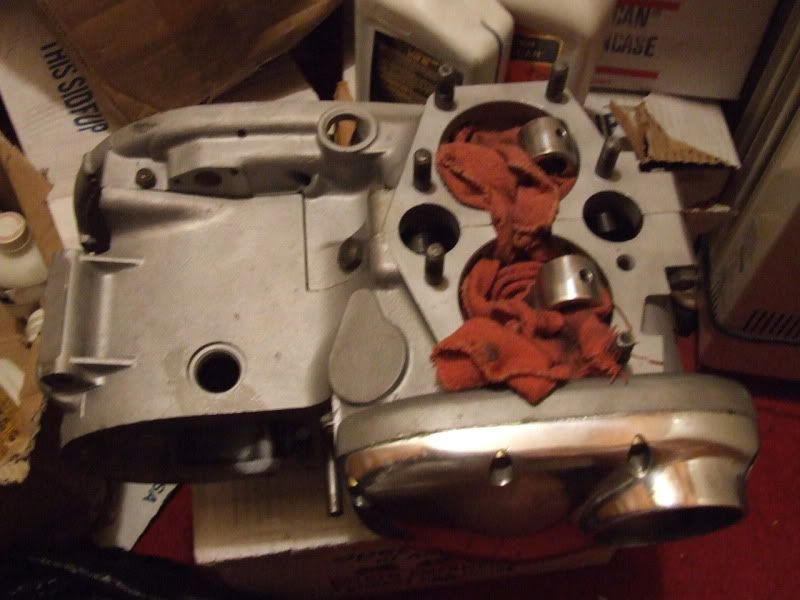

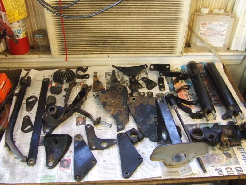

I have had this bike for about 15 to 20 years. I started on it and just now getting back to it. I just put a hack on my daily runner, which I like a lot but miss two wheels so this is what inspired me to get back to it. It is a 1971. Do to my situation might take me a while to finish it. As you can see some of the work is completed.
I am getting ready to totally redo the front end. All my bikes I have and had are daily riders so I will be replacing the springs, wheel bearings, any rubber parts and more as well as do a some painting. All I need to do it is springs and 2 o-rings. I have a kit of coned neck bearings coming.

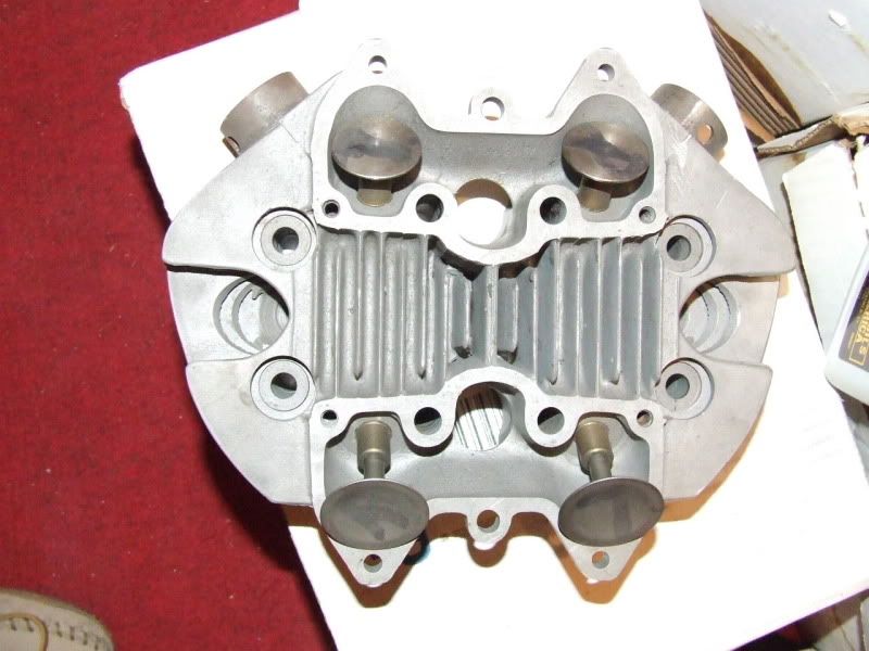

The head is ready which all I need is a new set of valve springs and clean everything and assemble. Might bead it again to shine it up as it has been sitting so long. Being it is as old is it is I like to put new springs in the head even thaw I have a spring checker.

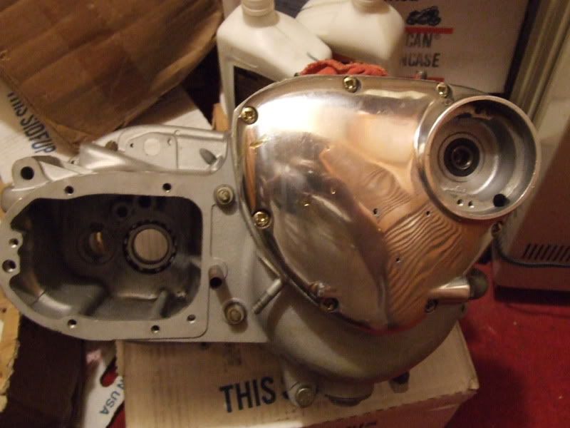

Bottom end is together all I need to do is install the transmission and primary drive. I use to have a cylinder blasted, pistons fitted and painted but do to my situation had to sell them. I do have another jug which is std but have to get another set of pistons, blast and fit pistons which I do my self. All so paint.
I all so had to sell my factory manual but I just got a reproduction factory manual. It came with R pipes but I am going to put C pipes on it and is my biggest problem to come do in my situation and not the eases thing to find. New ones if you can find them are VERY expensive. If any one knows where I can get a used set please let me know. I am all so looking for a under shield (engine guard) as I plain on doing a little off road riding. My oldest grandson who LOVES to ride who is 7 has a 4 wheeler and I would like to ride with him.
This go round will not be a full restoration but will come later when I have the funds but everything to make it reliable will be done. Later on I will tear it down and make it look real pretty like power coat the frame and so on. Right now I am going to line the tank and just paint it black.
Any constrictive suggestions will be greatly appreciated!

Rolling chassis

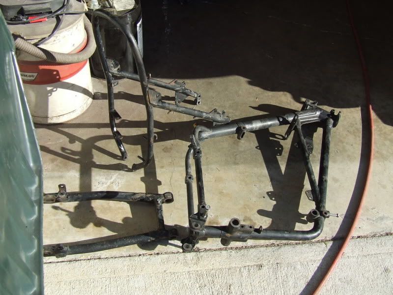

After getting the grease off the frame today I will either have to have it painted or powder coated.

Both my bikes came to me with them silly type bars. Never could understand it!
Paint or powdercoat is like asking about oil. Think the thing to bare in mind is choose one or the other and stick to it. ie, all the frame and cycle parts in one or the other.

Talked to the powder coat guy today and he said he would do the main frame, rear part of the frame and the swing arm for $125. At that price I am going to let him do all the fork parts battery box, foot pegs and so on.
I will be really happy when I am putting together instead of taking apart.

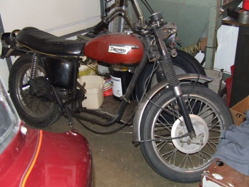

If you have not seen it here is my 1971 BSA Thunderbolt I did about 15 years ago but ended up selling it. Sorry did not like the one year gray frames so I had it painted black. Like all my bikes I ride them often. I have restore quite a few bikes not only for my self but others some have been featured in magazines .

Today I was doing some beading on a HD 59 motor I am building so I touched up some of my T100C parts that where beaded 15 or 20 years ago. All I need to put the head together is new valve springs. I have all ready ground the valves and did the seats.

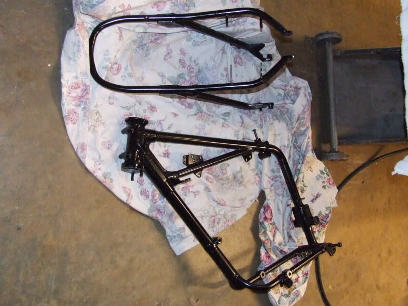

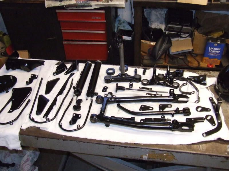

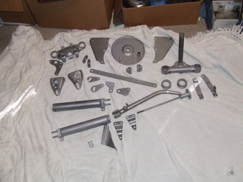

Being the guy doing the powder coating will do the blasting and powder coating on the frame, rear frame and swing arm for $125 I am not going to worry about doing much to them other then clean all the grease off. More then likely he is going to do it all for around $200 so being I do not do much powder coating will be cheaper to let him do it.
I have to do a little welding and finish bead blasting and it will be ready. This is the bead blasting I have done so far. My little 5HP 30 gallon tank dual cylinder single action compressor is not big enough so it takes me a while.

Most everything is at the powered coaters. Sorry do to my situation it will be a while before I can do much more. But is slowly getting closer.

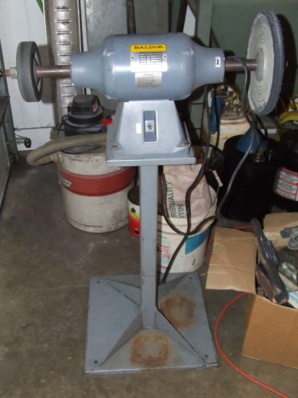

Did a little cleaning and polishing today. I am going to end up sanding the fenders, as the rear did not turn out as well as I would like. The front one I have not done anything to yet but the rear (left) I am not happy with. Still have about an hour or so to go on the primary. Might have to do a little more sanding on it to get some pits out I did not see the first time I sanded it.

Great to see this project as I am about to start a similar thing with my '69 T100C here in Australia.
I am really interested to learn what you have used for polishing of your mudguards. I would love more detail about the tools you use for these things.

Good to see someone besides my self interested in this build. Do to my situation after I get the powder coating back it will be on hold for a while unfortunately but will give me plenty of time to polish LOL. I am sorry to say this was a very abused bike and like many projects going to cost me a lot more then I had hoped. Someone even ran the rear brake shoes down to the point the rivets ate up the drum and this is only one of the many things I have found.
I have only done the rear mud guard (fender) so far and not happy with it. I can tell even from the factory it was not polished real well and has a lot of manufacturing scratches. Since I have so much time before I can do much with it I am going to sand both down starting with 220 wet dry sandpaper and work my say down to very fine 2000. I all so need to redo my primary as I stopped at 400, which left too many fine scratches. I have many machines and do my own machine work other then turning the crank. One of them being the below buffer. A buffer helps a lot but still takes a lot of handwork including the final stage polishing by hand. On aluminum I use Never Dual as the final polishing as it leaves a protective film that protects it form oxidizing.

Picked up the first batch of parts I had power coated. Have to take two things back to get redone glad they are only 2 or 3 miles away. It is semi gloss.
Hate to but this project is going to be on hold for a month or two I hope that will be all. When to a funeral yesterday and on the way home the stator on my rig gave out. I am going to write Harley and tell them it only lasted 90,000 miles LOL. Will get back when I get more done or news.

Looking mighty nice, Jeff. It's great to get a big batch of pretty stuff like that back at one time. Course, then you get to sort it and store it.
