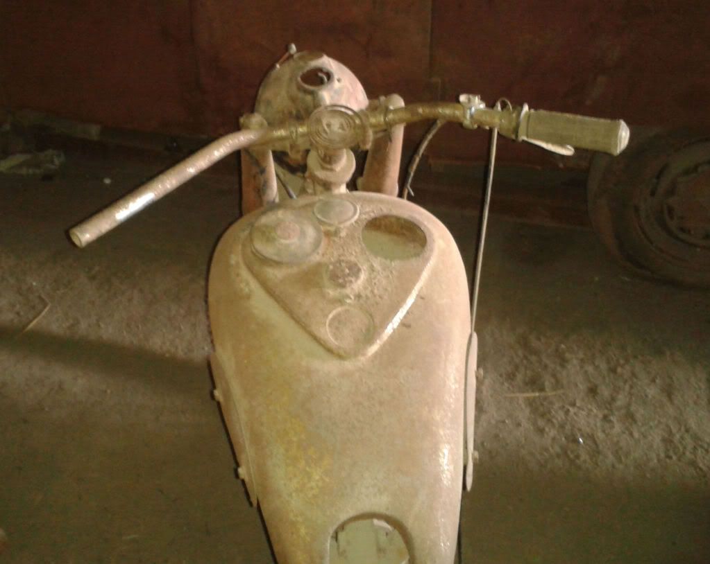

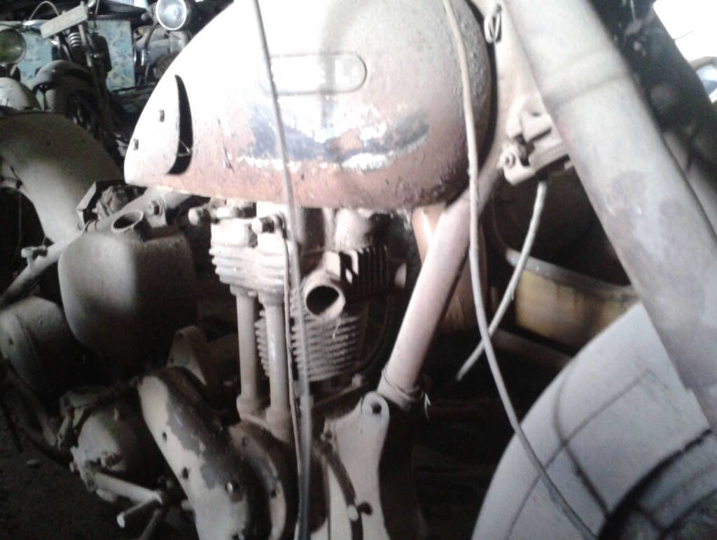

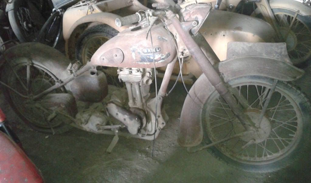

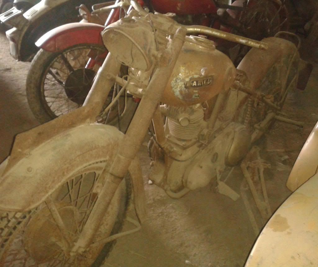

This one is a mystery to me. Excuse my ignorance, for I am not very acquainted with Ariels.
Can anyone please help identify the model and year of this Ariel? There is no engine number that I could find on the left side of the motor, apart from the raised part number of the cylinder.
Could this be a Red Hunter from the late forties?

That's quite a find, I've heard that container loads of old UK bikes are shipped to India for some reason... environmental perhaps? It looks like a late 1930's red hunter 350. It's unusual to find one as complete and original as that. Evidently it even has the original low bars based on the pics.

Based on my information it would appear to be a late'40s VG500. It has the valenced front mudguard of that model and the oil tank is the larger size as fitted to the 500s. No pre-war Ariels had telescopic forks - they were all girders. The VGs were lower priced than the VH Red Hunters.
The engine number should be on the left crankcase just below the cylinder.

Well, that's exactly what I thought this one is - a late forties model. I checked exactly where you said I should look for the engine number, but there's nothing there.
The cylinder looks awfully small to be a 500, I reckon. But I could be wrong about that. Any ideas about how I can confirm the model for certain? I need to know because I'm planning on starting the restoration work soon and there's no way I can look for parts without knowing which model they are for.

The frame number should be on the right side of the bike on the tube under the saddle. The engine number, at least on my Ariel, is in quite small print immediately above the word 'ARIEL' on the left hand crankcase and just below the cylinder flange. It could be difficult to see. There are several sources of year/serial numbers on the web so this shouldn't be too difficult to sort out.
