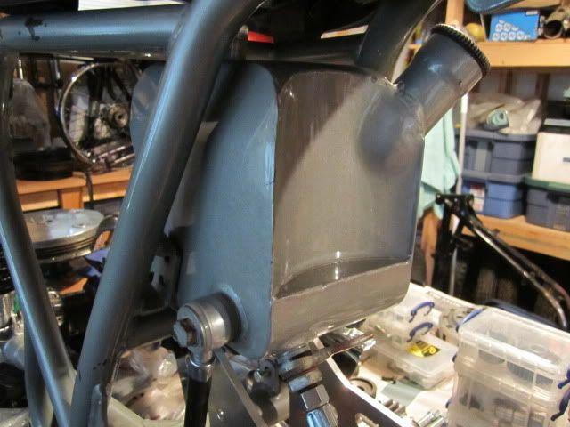

You need to find a proper "Clipper" Oil tank. Your's looks a bit too 'Goldie' ish.
I see that now that you mention it, it's dished out for the remote bowl, or is it the airfilter.
It needs a flat front to be "correct" even though that tank should work.
I'd be looking for an alloy fuel tank.

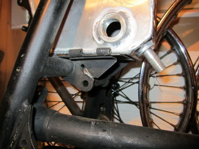

The petrol tank I have is a very small alloy tank, similar to the B50MX (could well be a B50 MX tank), this might be a little too small so might go for the the two gallon Catalina tank instead, I also have the standard European tank but that will look strange on this bike).

I realize the oil tank is not correct, but neither will be the frame suspension, carburettor, seat, etc...it's fiberglass, looks right-ish and weighs practiacally nothing. I like that.
I'm gonna keep my eyes open for a ratty lyta tank, but until then, I haven't made up whether to run the steel tank or a victor tank. The benefits/penalties are obvious, but this is a low priority and I have both.

I'll trade you a 'flat front' Clipper oil tank for your GS tank.

Alex, Just say NO to the 'Victim' tank. If you follow the AHRMA scrambles/Trials guys around you should be able to get a pranged Alloy Goldie tank.

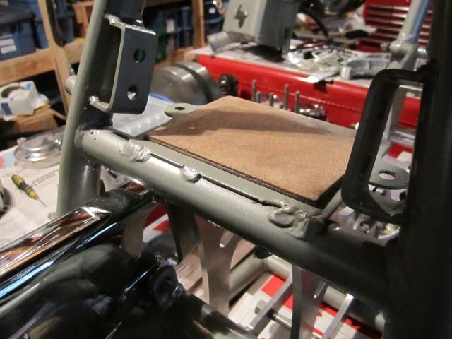

Alex: The central oil tank platform is added onto the standard frame as per the photos below. There is nothing to remove to add the platform.
The tank should fit inside of the brackets used to bolt in the battery platform. Not shown is the metal strap that goes over the top of the tank. I will add that photo later.

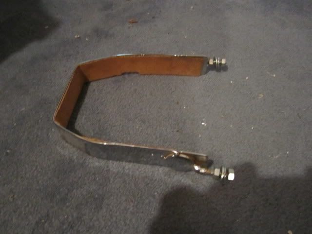

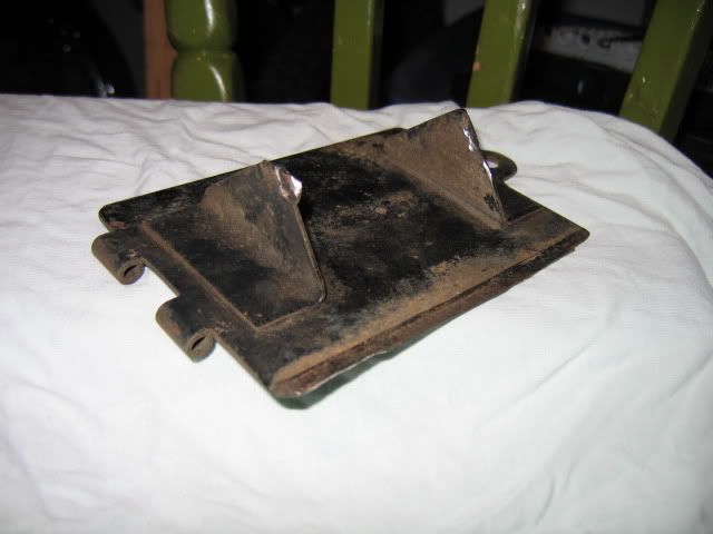

Alex: This is a strap for an All Sport frame, it uses two threaded ends where as some earlier versions had one threaded end and a pin through a hinge on the other side. This one has cork glued on the inside.
This is a top view showing how it is tacked in. All the battery tray brackets are still in place.
The tank fits in quite tight.
