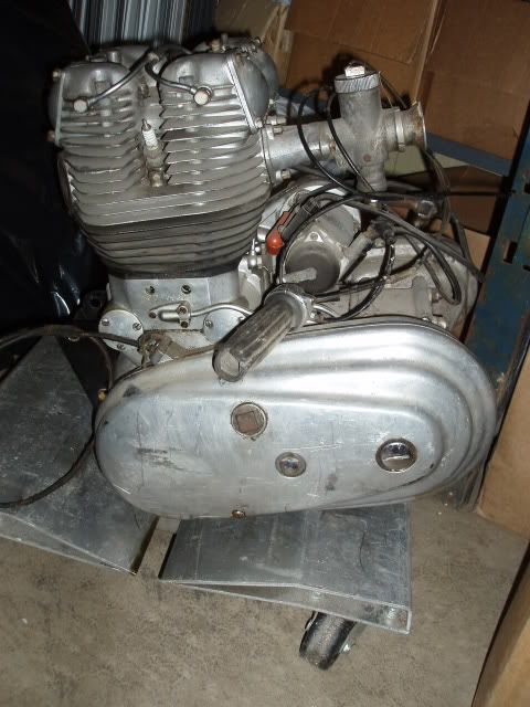

Just joined up and this is my first post. I have a twin cylinder, single carb, Indian tagged motor in my possesion. The number stamped on the left hand crankcase is CDH5962B. Can I get some help in idntifying what model and year this motor is from? Thanks.

I think you are on the wrong forum here, C'dog. That isn't a number from a British-made Indian. I presume the motor you have is a Vee twin, in which case the CDH indicates an American-made 1948 Indian Chief.

Thanks for the reply. It is definitely a vertical twin. Defintely not a v-twin. I'll try to look for more numbers but these are quite visable on the left hand side below the cylinder and above the primary chain cover and just above an aluminum plate that holds a rear chain oiler tube that extends back to just above the front drive sprocket. The Indian logo is where the Royal Enfield tag would have been on the timing cover. Red script on a flatened oval. The 4 speed trans with neutral finder is bolted to the rear of the motor and the front motor mounts are in place and look very similar to Indian made Bullet motor mounts produced today. Thanks.

I don't know what to say about that, C'dog! Very strange. Any chance of posting some pics?

Yep, took some photos now just trying to slog my way through the posting process. I'll try to have something up shortly. Thanks[Linked Image].[Linked Image].[Linked Image]

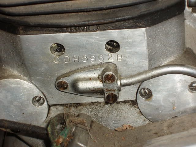

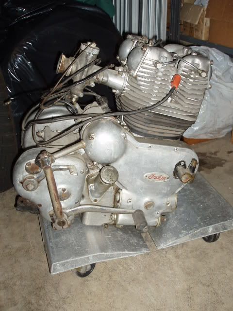

Posted a few photos this a.m. Any ideas? Thanks.

OK. This looks like a late 1957 or later 700 twin, with the scissor clutch introduced in the late 1950's. The revcounter might suggest it was originally from an Apache, which was the only model with a tacho as standard, but the timing covers are easily swapped so it isn't definitive.
However, those are absolutely not Enfield factory number stampings; the crankcase has visibly been machined to remove the original numbers, and without those, the engine cannot be accurately identified as to it's exact origin. Strange thing to do to one of these - possibly somebody already had an Indian title with those numbers on that they wished to use. Or, perhaps it was stolen and this was done to hide it's identity.
There is one thing more you can check which might pin things down a little. On the right side top of the gearbox, there will be a number consisting of three letters followed by two or three numerals. This is the gearbox number, which should also be stamped on the front of the right-hand crankcase, indicating that the two were paired at the factory. They should help to narrow down the year of production.

I find HDX 352 on the trans but I find nothing on the front of the crankcase although it does appear that some filing might have gone on in the area of where the numbers should have been on the right, front of the crankcase.
It is funny that the serial number for the motor would have been machined away. I agree that the area has been machined but somebody would have had to go to a lot of trouble to machine that area. Also, the machined surface matches perfectly to the cylinder base edge. Can't figure what a motivated thief might be willing to do to keep a bike or hide a bikes ownership.
I notice the cylinder base have BMC cast into the side bottom edge as is visable in one of the photos. Would that indicate replacement cyclinders. Thanks

HDX transmissions were grouped in the 1958 manufacturing year and were used on Trailblazers & Apaches. The prefix CD was only used on Meteor Minor 500cc machines in the 1960/61 time frame but the H for "Heavy Crankshaft" was only used in a spotty fashion on 700cc engines plus the number would have been above 30137 for a CD prefix. The Indian logo indicates USA import parts plus the 10TT9 carb and K2F type mag points further toward Apache. The cylinders appear to be the 700cc and are taller than the 500cc cylinders. There are some good bits there but the crankcase is unidentifiable to any information I have. Graham would have more info than I but it does look "restamped" and the access bolts are plumb missing from the ports there too. They might have done some welding & filing to obliterate the previous numbers. The prefixes were usually stamped in front of the first access hole there then the number was between the two ports there and usually above the centerline of the ports not below.

Thanks for the info. Looks like the motor might have had an interesting past. Thinking about putting it into a later model 500 cc single, Indian manufacture frame. Looks like it might fit straght away. Any thoughts on the installation? Thanks.
I'VE Seen this done with this very engine. It apparently slots right in with some modifications!

The India built single frame is a lighter duty frame than the ones built in Redditch. You could likely get it to work but it might have structural problems eventually due to the higher power output of the big twin engine. The big twins used that type frame prior to 1956 but were improved to the heavier frame due to structural problems. Royal Enfield made use of steel forgings on key structural areas where the Madras/Chennai frames did not.
If a person could scrounge up an old Indian Trailblazer, Apache, or Chief basket case they'd have a good chunk of engine parts to build one up. They still show up on flea pay now and then.
