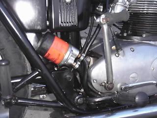

Here's a custom made spin on unit I have fitted to the ski slope on my 54 B33.
It takes an element from a honda dirt bike
Keep It Greasy

Looks a lot like the one I make:
I am making new tops with both ports horizontal for more mounting options.

Posts: 190
Vancouver Island Canada
Salty Dog Offline
Salty Dog  Offline
Posts: 190
That filter unit on my B33 is one of yours DMadigan...it's a fine bit of kit still going strong !
