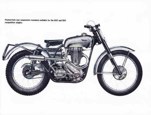

Hi Bill, I'm going to post a factory picture if I can remember how to do it.

Well, it worked albeit a bit big. Beezageezauk.

Thanks Beez,
Any idea if the oil tank is chrome or painted? ALso, what type of footpegs did it have?

Bill: The oil tanks were painted steel and the pegs were the standard fixed types with the through bolt holding them on.
That photo posted above is better than anything I can find. There is a chap in AUS who makes the rear fender bracket, I will look for his email address.

Gordo has it right also notice 2 gal tank has a breather like the goldstar with a sct gear box

The artist conception above is one of the few from that time and it is used in some refs to represent the Clipper and at other times a trials Gold Star. I prefer photos over drawings for details but real photos are hard to find. In Bacons Illustrated Legends BSA book pge 55 there is a photo of a Clipper and it appears that there is no breather but the angle makes it hard to be sure.
Below is the alloy tanked machine "Competition B32 and B34". As well it seems that some competition units came with GS engines.

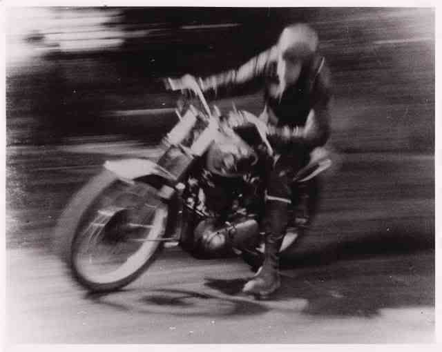

Wilf: Some vintage Clipper shots.
Wilf at blurring speed!

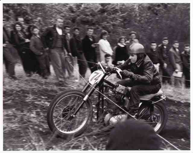

Hillclimbing near Victoria (nice fuel tank)

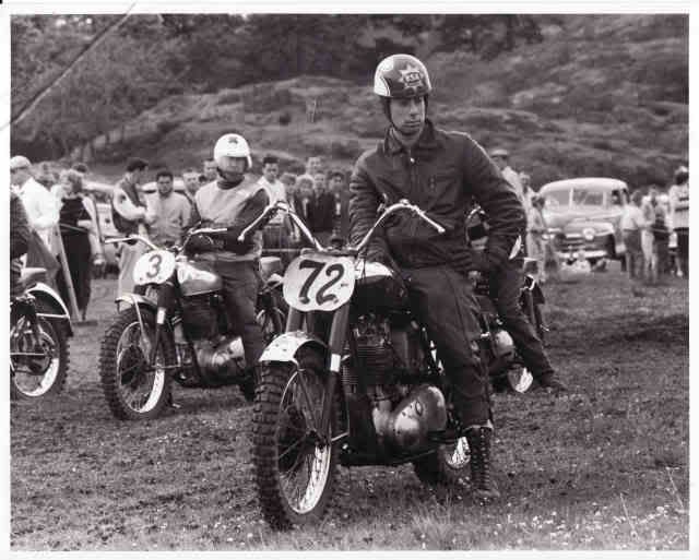

John Davis awaiting scrambles start on his Clipper. Victoria
