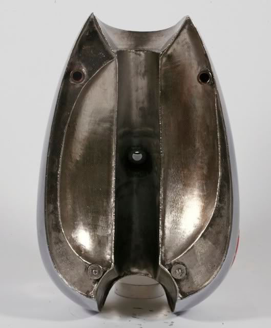

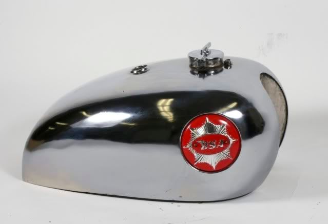

is the 4 gal tank you refer to alloy and the same shape as the 4 gal steel GS tank? check my pics of my 5 gal alloy tank

That's the exact tank (except the paint) I am trying to locate through TA Baker in the UK. How did you find yours or who dod you go through? Thanks for the sweet pics amazing stuff!
