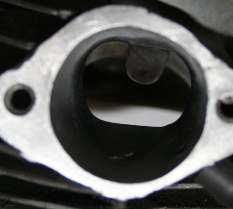

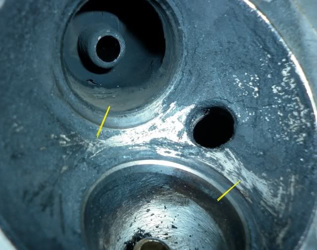

Hi All,
Coming up to time to do a top end overhaul to freshen up the rings on my '69 A65F. Have had issues with valve spring coil binding in the past and now valve sticking so will fit new valve springs from Ed V and possibly new guides and black diamond valves if the old ones are not right.
I have 2 heads to choose from, the one currently in use on the bike or a spare that I replaced because the seats had been cut a bit deep (by a **** head shop that I wont be using again). My question is: 'does the recessing of the seats REALLY matter?' I'll see if I can get a photo later today. It's probably not too bad. This bike is used as daily rider mostly commuting but would like it to perform as well as it can and to use it for longer faster runs as well. I blended the worst bits a little, but is there REALLY any SIGNIFICANT shrouding and would this matter on a street bike? Does this cause problems with spring setup? See the pic below. Most obvious where I have added the yellow lines. (Bit embarrassing the amount of oil carbon on this but the heads got swapped when I did last ring change)
Also, seems the earlier smaller ported heads have better mid-range. Not sure exactly what heads I have. What is the easiest way to tell the earlier and later heads with different inlet tract sizes apart. Casting numbers? Rear head bolt size (but mine may have been alterd)? I think the one currently in use is a later head, but uncertain. Added at edit: Both heads have 68-701 casting number.
Final question and one that relates to the last question is cleaning up the inlet tract. EdV told me A65 inlets are a bit restricted around the guide area and they can be taken out a bit in this area. My concern is that I dont want to lose any of the low end on this bike as it does get used mostly in traffic. My plan is really to leave the inlet tract alone unless there is really something useful to be gained here. I'm running a megacycle 542-x2 cam (and 930's) which I find has good mid-range, but the x2 cam did lead to loss of some off-the-line driveability. Dont want to exacerbate this. My feeling is pretty much anything I could do would be detrimental rather than helpful. The inlets already seems to have been bored, possibly with no taper. Both heads much the same see pic below. Goal would be to increase gas speed I'm guessing rather than just try to increase overall flow. I'd be prepared to mess around with one of the heads I guess. Not really aiming to diverge from standard just want to optimise what I've got. Definitely not trying to build a race engine or push the useful rev range up higher.
Added at edit: now looking at the dismantled head it clear there is a bit of a bottleneck around the guide. The guy who will be doing my head this time is an experienced motorcycle head specialist I will discuss with him cleaning around this area. Anyone have any input into that?
Thanks in advance

It is my information, available to me anyways, that any shrouding of the valve is not good... And while the "blending back" of the head material might have helped the gas flow, once you try to replace the seats, unless you reweld the aluminum {?} of the head back up, or unless you replace the seats with larger diameter seats, the stock seats will protrude down out of the head, with the blended area still blended back, won't it?
I think the springs would have more length to go, before coil binding, unless when they checked installed height and reshimmed.... OR the springs were already weak, or collapsed, aaaand reshimmed....
I have one "small valve head". The small valves disappeared into any of the large valve head ports, no contact with the seats.
I ended up replacing all the guides and valves, none of them were useable with any of these heads, all were worn and loose in their guides.
Inlet tract: I personally do NOT like the rather SHARP 90+ degree bend in the inlet, right at the valve pocket.
I took a dremel and fine sand paper to this area, and made it much more rounded, hopeing to make the gas flow path easier.
We will see what happens...

Cheers Brett,
Yes, appreciate the problem with blending and then replacing seats. Didnt really have a lot of options at the time. The head guy I have found can do the welding,and new seats but the head with the recessed valves I'm treating as a 'spare' really. At the time it was cheaper to find a replacement head than go the 'repair' option. Not sure that's the case anymore with USPS to Australia getting ridiculous (I saw $44 for a set of (2 stroke) rings on some evilbay sellers this morning!!). Heads in Australia are not that easy to come by at reasonable prices.
People I have approached about seats tend not to like the A65 as the seats are not Concentric with the guides (or so they tell me). In any case I've done about 7-8000 miles on each of the heads I have. Havent pulled the valves yet on the current one, but the exhaust seats on the pictured one were pitted. The inlets were perfect. Not sure whether this will fire up a discussion on the requirement for hardened seats. I try to use lead replacement additive when possible, but dont always. I purposely avoided any talk of seats in my first post as there are strong and diverging opinions on that one and wasnt seeking info on thet (yet shocked ).
Looks like I've got other problems as well, havent pulled the barrels yet but looks like it had been sucking oil from the pushrod tower and a fair old carbon build up in that area on the piston crowns.
Looks like I'm confusing valve size with inlet tract size. Need to go and find some of Rich B's posts but I find the search function to be pretty RS.

Ray,
It sounds as if you may need to check the flatness of your head and barrel mating surfaces... For the oil consumption...
There were at least 4 A65 heads at Steubenville today... About the only 'common' part available there... Didn't need one, so never asked for any prices...
...I did think you were talking about two different things, re: valves and inlet tract.... I wasn't aware there were more than one inlet tract size...? Except for the single carb heads being different from twin carb heads... True A50 heads being different from True A65 heads... STOCK, and not worked on!
Brett

Hi Brett,
Spot on, I will get the head checked and skimmed (as little as possible) if necessary.
Valve size / port size: I was under the impression that somewhere around '65 had smaller ports but with the large valves. Often get confused with these things until I research them in detail.
Used to enjoy the Steubenville swap when I lived in Pittsburgh. I'd like to be able to do the swap meet thing rather than eBay, but there's a small small problem of distance and time. Swaps in Australia stopped being useful for me a long time ago. Havent been to one in years.
Turns out the inner exhaust spring was broken on the timing side exhaust. Another good reason to use decent springs if you can get them. Did have what seemed to be a loss of compression on that side a few days ago. My timing for the rebuild couldnt have been better. I have already got all the parts I should need. I was stuck using these old recycled springs because the replacements I had were coil bound or so close that it didnt matter at full lift. Because I use the bike as my only mode of daily transport I sometimes have to put it back together with what I have. There was also some evidence the followers were bouncing on the closing side of the lobe. So all-in-all the springs were not up to it.
As always, should be better when this is all done. Slowly getting this bike sorted.

Thanks for the clarification on that one Allan.
Both my heads are the 'big valve' then with casting number 68-701.
Seats were not as nice as the one pictured, but will get all the new bits I have and a 3 angle cut.

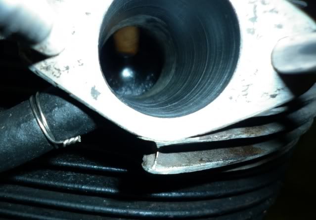

Ray, having new seats fitted is a pretty simple not too expensive excercise if they are deeply recessed. They often get deep with the use of modern valve seat cutting machines that do 3 angles at once. Three angles is definitely the way to go with narrow seats which are not recessed. I do my seats with grinding stones and the seal seems better than any other way, it's just a bit time consuming getting them exactly the width and on the valve where I want. I use the std seats with unleaded 98 and use no additives, the seats do not recess nor give a problem. I use nitrided valves in Kliners and they can run tight clearences without sticking.
I haven't tried it on a head with std valves and std carb sizes but if you alter the shape of the port esp around the turn under the valve guide you should be able to pick up gas speed and flow.
This is with opened up inlet port without any filling in the floor of the port.
This has more or less the same port with a filled floor, its built up under the guide but the port is well opened up, on a std port taking material away from the floor under the guide is likely detrimental, smoothing might be ok so the curve is smooth but not digging it away.
The open port flows a lot of air and makes a motor very powerful in the top end. From what I've read the floor of the port where the JB weld is built up is a dead flow area and possible source of turbulance. What that means is that filling it does not deminish the top end flow and power, however it makes the port smaller and so the gas velocity in the port is raised, so the difference between the two heads is the lower one gives better power from lower RPM and at least as good in the top end. The motor is actually up about 4-5HP with the second style head but as I'd rebuilt the motor that might have been due to something else. What was noticable was the better power spread.

Thanks Mark,
I'll be talking to the head man today. I think I just havent found the right person for the seats yet.
Will just go with the 3 angle cut and I'll get him to clean up the ports in the way suggested by EdV. Dont feel quite up to doing that myself yet. I reckon that building up the port floors is definitely a good idea and will consider that for the next iteration if I feel that I need to 'fiddle' some more. I would feel OK with doing that myself. I'm with you on your views you've expressed many times on keeping gas speed up.
I tend to run the bike, see what I am not happy with and work on changing that at each rebuild. At least (AFAICT) I've got the bottom end sorted finally.
