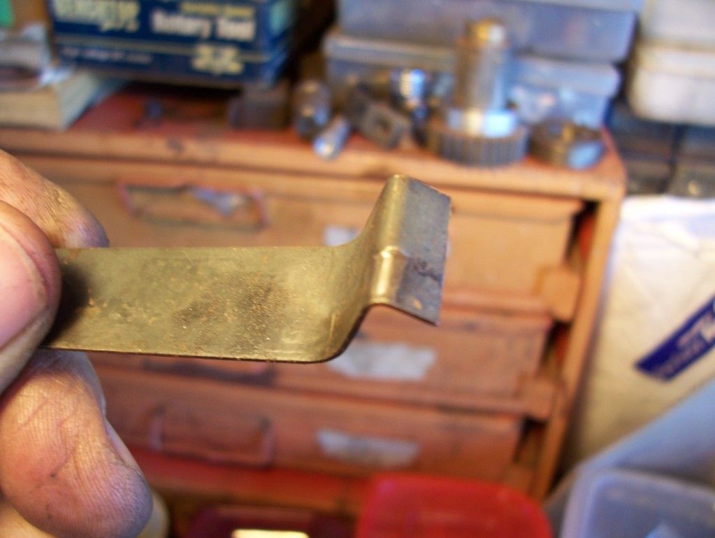

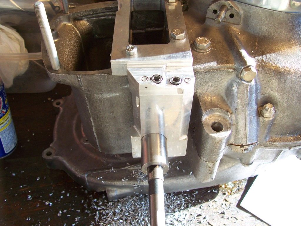

Looking further into this gearbox, I may have found the culprit with this 'box jumping out of 4th gear.
This first picture is how I initially indexed the shifting. In this position I can shift through all the gears. HOWEVER, it feels like a "half" engagement, for lack of a better description, in 4th gear.
Then I experimented with this indexing. I indexed the 'box in 4th gear because of the nature of the leaf spring means that it makes contact with the camplate as the inner cover is pushed home.
In this position, I can also shift through all the gears, but 4th gear feels completely different. It seems to go all the way into gear and by pushing on the shift lever, (ie. trying to access a 5th gear that ain't there)I feel a a resistance as if pushing on a spring. Hope that is a good description. With the other indexing, the feeling is like pushing against a dead stop.
I've put a fair number of gearboxes together over the years, including five speeds, but I never had one that would shift through all the gears while indexed in two different positions. When you get it wrong with a plunger type 'box, once you get to 1st or 4th, there's a no-man's land waiting for you where you go past all the shift detents and get stuck permanently. The 'box has to come apart.
Well, I found this also.
It looks worn out to me, so this and the support spring got replaced. I also replaced all the springs in the outer cover, replaced the rusty and banged up guide plate, installed a new bushing to replace the worn out one, and installed new seal. I also did half the service bulletin. I elongated the mounting holes of the support spring so that it "supports" the main spring a little more. It feels pretty good shifting up and down, just like you would expect.
Has anyone had a similar experience with this particular gearbox?
It's got me scratchin' my head....again.

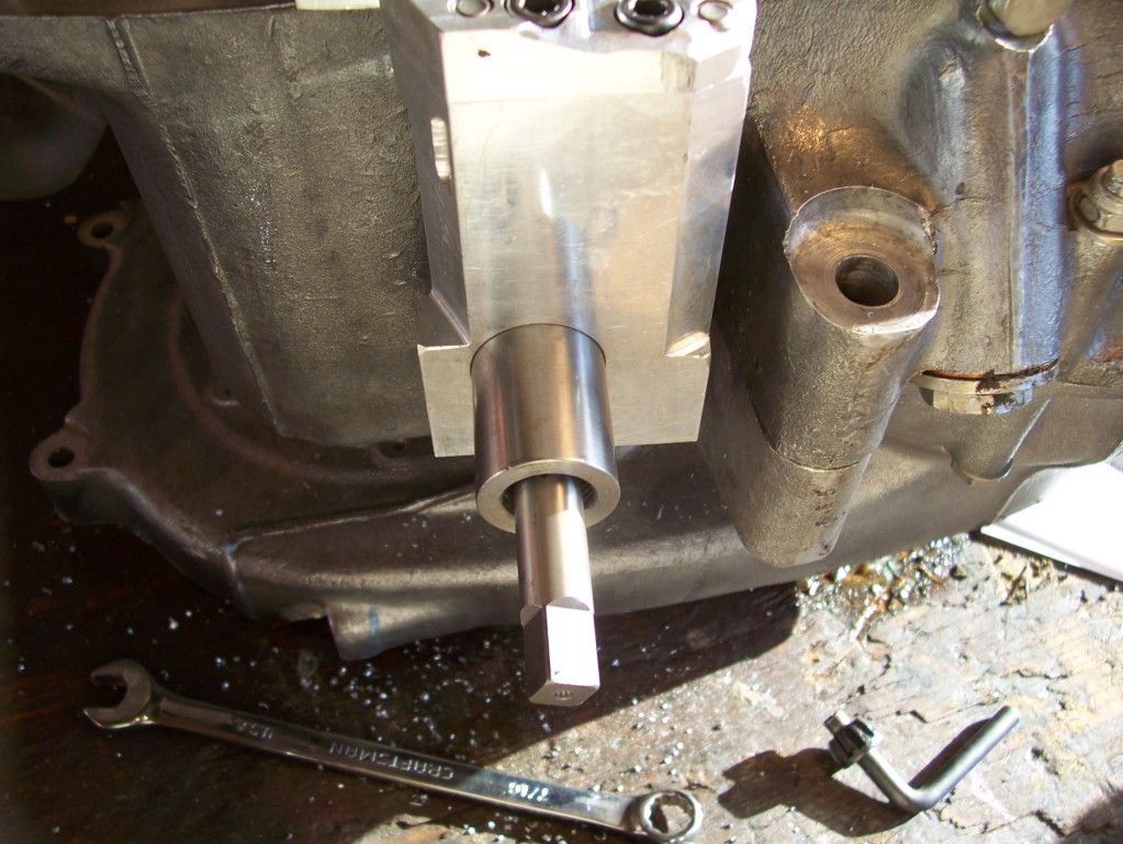

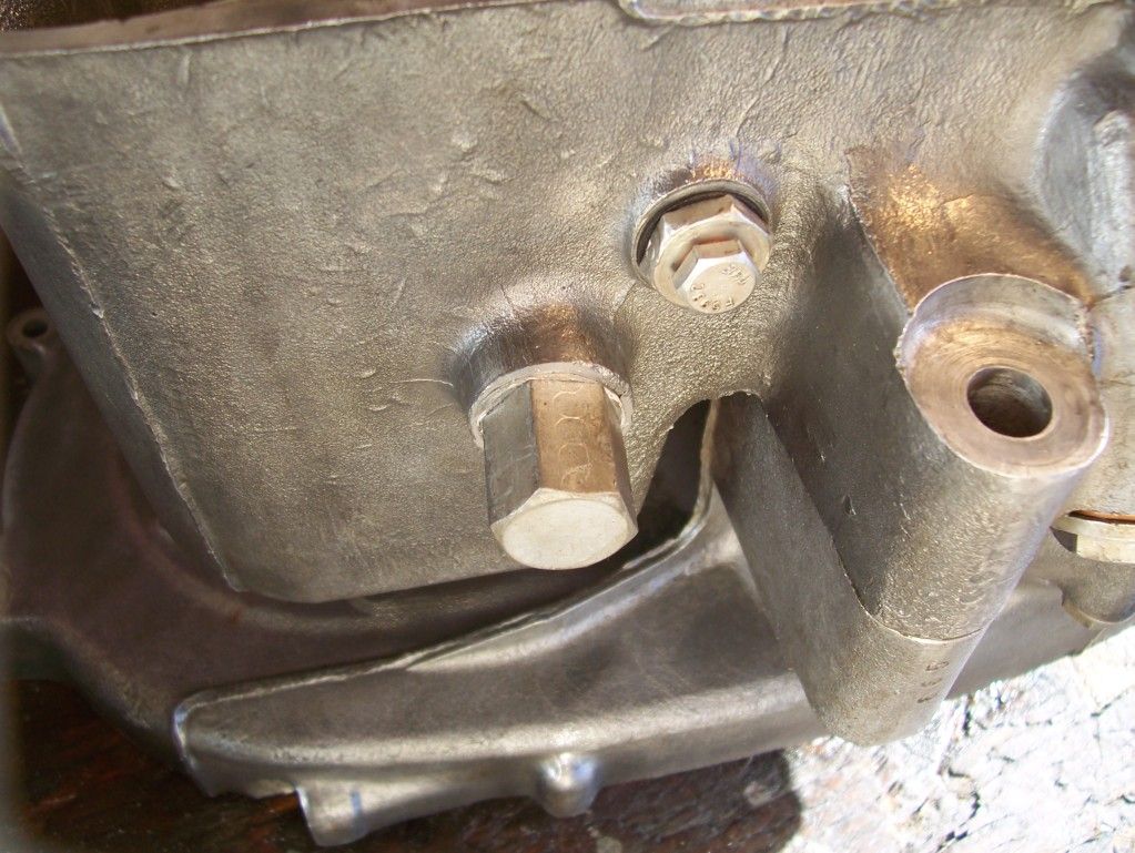

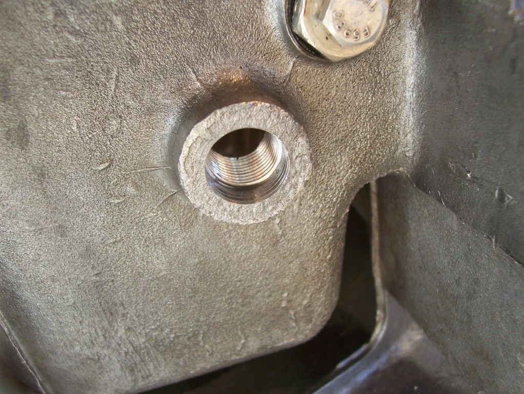

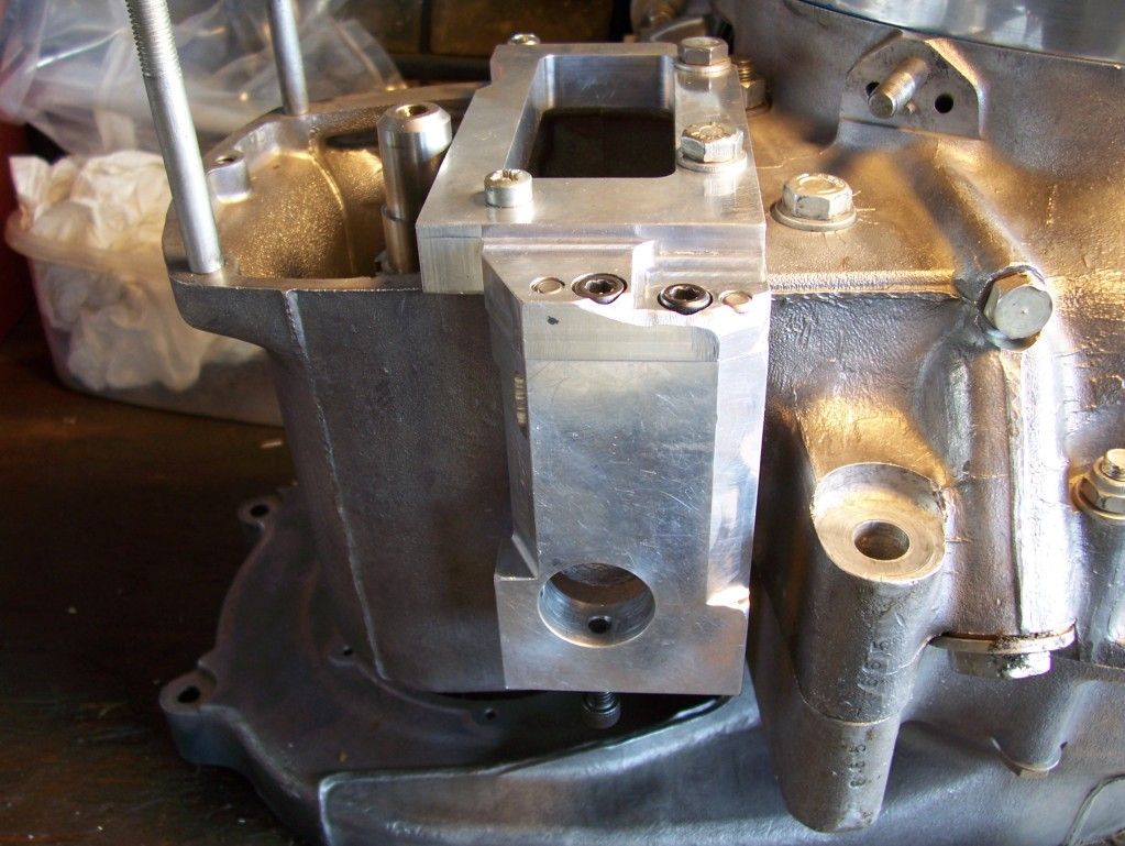

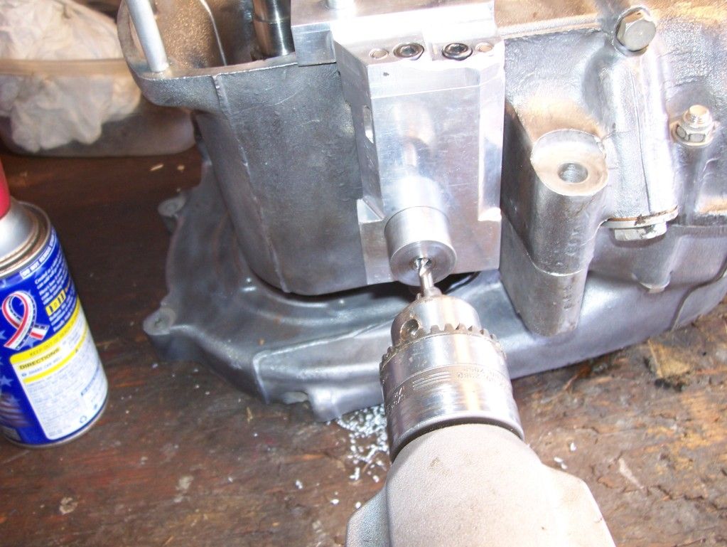

I finally got in contact with Buckshot 1 and rented the kit for the plunger mod. It got here today and I got right on it. First, I'd like commend Mike for a hugely professional job on the kit. It comes in a purpose made wooden box and the jig itself is a work of art. Well, see for yourself.
He emails you a six page set of instructions, which covers everything. If you have very little experience with this type of thing, not to worry. He walks you through every step.
You first drill a pilot hole, then the exact diameter hole for the tap. Then you ream a relief for the non-threaded part of the plunger body, then tap the hole. All done with bushings that insert into the jig. Very precise. I'm also very impressed with the shifting now. It feels much more positive, I think, than even the new leaf spring which I installed after thinking I would never find Mike.
Anyway I'm glad I did it because, well, the factory did it, didn't they? I think it is likely a workable thing, that leaf spring, but it sags before long and changing it out is a much more involved project that changing a plunger spring, isn't it?
Here's pix of the process.

I used that very same jig from buckshot. I wonder if it has made it to every state in the union yet?
