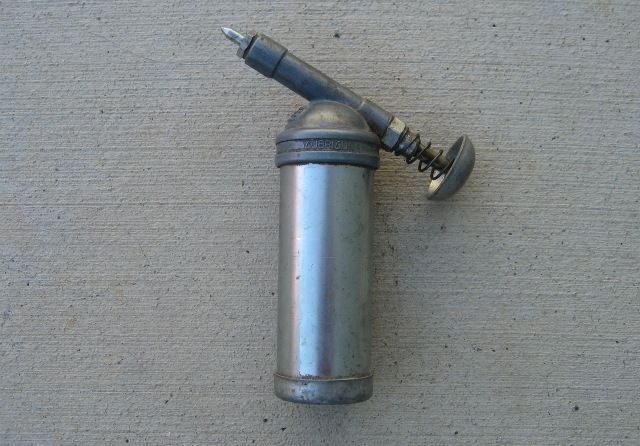

The little hand grease guns with thumb plunger button utilized for lubing chainsaws work on the original style fittings as the gun is pointed on the delivery end. It pushes on the grease fitting ball and seals there at the same time.

Why change all the fittings when a small grease gun is available for the originals?

Is that a vintage item only Gary. I havent seen one before. Just asking since I too like the idea of not changing out all of my fittings.....

This looks like the one Gary? Same fitting though????
http://cgi.eBay.com/ws/eBayISAPI.dll?ViewItem&item=280774374872&fromMakeTrack=true&ssPageName=VIP:watchlink:top:en#ht_1898wt_907

The eBay items looks to be the same, or get one at the local chain saw shop. Don't know if Lowe's or Home Depot carries them or not.

Thank you Gary E. for being the voice of reason...again. Small grease guns for sale

Harbor Freight sells small grease guns like that. As usual, not the best, but they do sell them.
I find it a bit difficult to use. I just remove the zirk and squeeze the grease in the hole.
