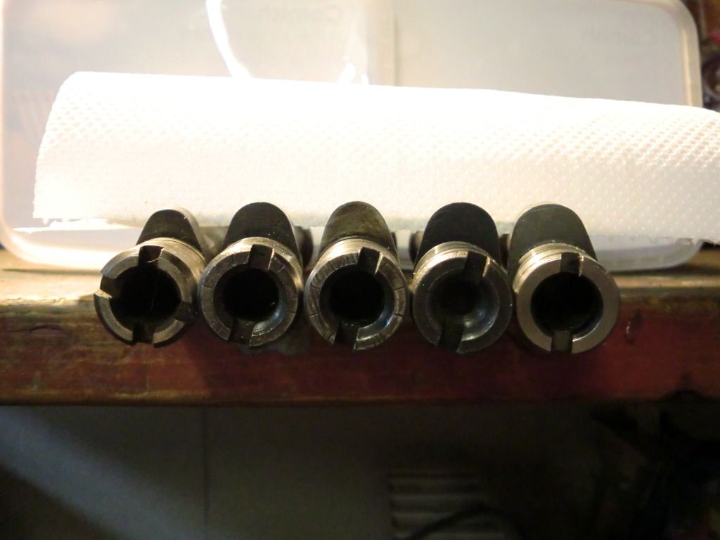

What's the difference?
I have seen some cams which come to a point ( almost ) like a quick duration of opening
I have also seen cams with a wide lobe, I'm guessing a longer duration. I am assuming that the cam which has the shorter duration is the hotter cam ?
The wider lobes are the go-faster cams. I don't think the eye can see the quietening ramp on a cam form. It's just the transition from base circle to lobe flank.

By way of comparison, here are some of the more popular Triumph cams, sorry about the quality.
Left to right:
Early E3275 standard cam, E3134 Bonneville cam, E4220 Thruxton, 71-3011 T140 inlet, Nourish Z cam.
