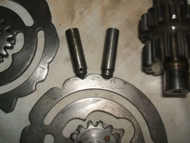

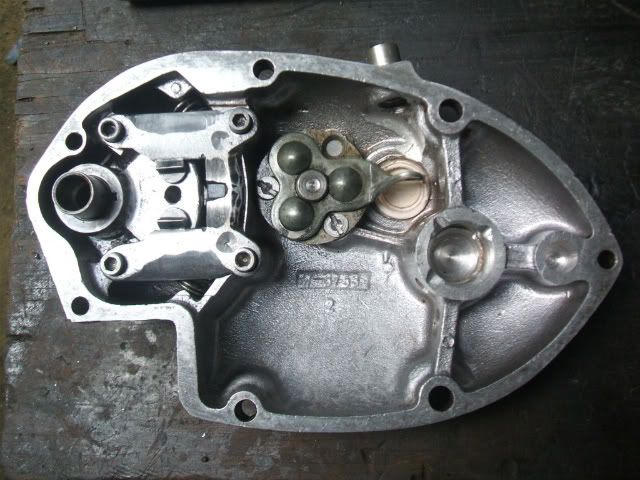

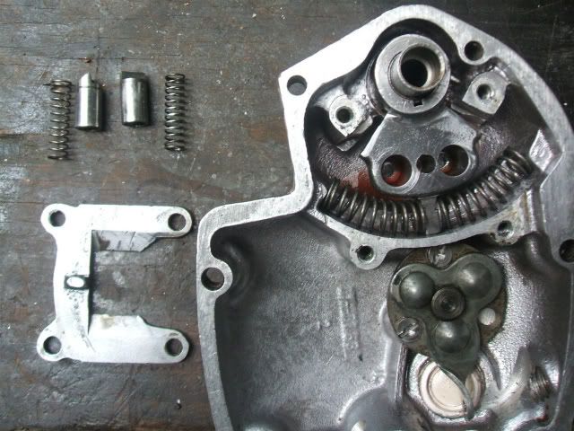

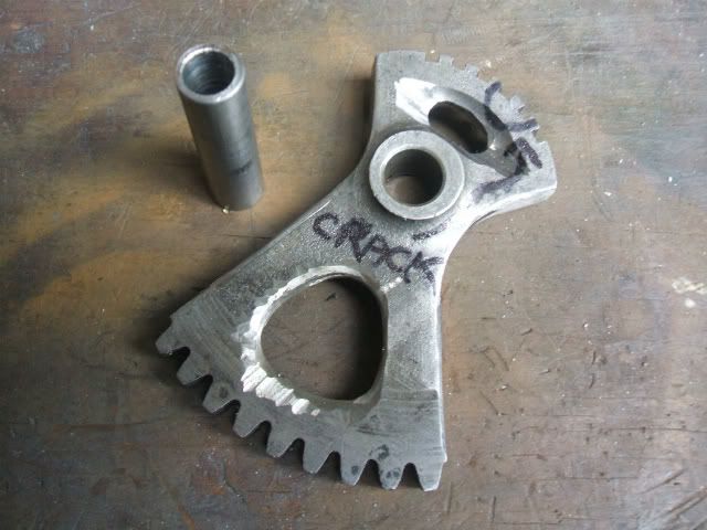

Here are photos of the T140 dragbike gearbox that is giving intermittent issues with changing gear. The gearchange in question is either into 3rd or into 4th. The lever initially locks solid, but changes OK if released, then re-activated. It's difficult to remember which gear it is, as during the race, everything happens rather quickly! It certainly isn't 2nd or top, so that only leaves 3rd or 4th.
You'll notice parts are lightened with a significant amount of material removed. Lightness is a key factor which makes this bike go as well as it does. I think carefully about what and how much material to trim, but I may have created the issue with some of these mods.
The gear lever spindle is hollow. The selector pawl plate has had material peeled off, drilled and chamfered. The outer cover was made from one that was already broken at the flashing.
Here is where the quadrant fits to the inner case. This was the best shot of a difficult to capture issue. Look where the quadrant pin area has been milled. Part of the area around the hole was too low for the mill cutter. Obviously this happened at the factory and could be a result of not enough material allowed for in the mold. This allows more sideways "rock" of the quadrant than would otherwise be desirable.
Here you'll see an extra hole drilled between where the pawls are housed. One pawl has an identifying groove. Their springs have about a millimeter difference in length. The bigger springs were renewed recently. The plate that covers these was pruned and modified. Where the spring ends contact this plate, the tit was built up and squared to give a fuller "rest" for the spring ends.
Here is the crack (circled). Probably it's been there since before the bike was run for the first time. It was hard to spot but upon closer inspection the tooth is slightly bent as a result of impact, is my guess. The pin is made from silver steel and wasn't hardened. It's a closer fit than the original by a thou or 2. The quadrant sure was hardened!!
This gearbox was built from leftovers so mismatching is a distinct possibility.
Questions:
Is there any known issues with mismatched items?
Would it be worth shimming the quadrant endfloat to say .002"?
Is it worth shimming the gear lever spindle endfloat to say .002"?
Is it worth adjusting the layshaft endfloat to say .002"?
Is the camplate worth having a look at for endfloat shimming?
A later camplate is used with more factory removed material from the outer. Are these as good as earlier "full circle type"?
As original, a quadrant is split pinned to its' shaft. Is there any advantage?
Any other tweaks for a sweet changing box?

I've never had any trouble with my 5 speed doing clutchless shifts, but here are a couple of brain farts which may help (no doubt I'll be told I'm wrong again but it works for me)
I think the bush in the gears sometimes move, some have a notch cut in the gear and the bush is peened into it to stop it happening.
You said the box was built from parts? The 4 speed and 5 speed pawls are different (one has the edge half way across the diameter and the other about 2/3rds), but I don't think it would change at all if they were wrong.
I've shimmed my positive stop up so it slighty under selects. Momentum carries the plunger into the v notch. I assembled the camplate and selector mechanism and dropped a bulb thru the sleeve gear bearing to see what was happening. The shims are pieces of angle held under the pawl plate which has to relieved a bit to take them. There's a good photo of some in the Shenton book, showing the 5 speed Quaife which uses the same principle.
I did once have a problem with over shifting, but that was cured by deepening the index plunger notch by a mm.
When third jams, is it actually because you're still trying to force second in as the lever and pawls haven't restored to centre?
Just some thoughts...

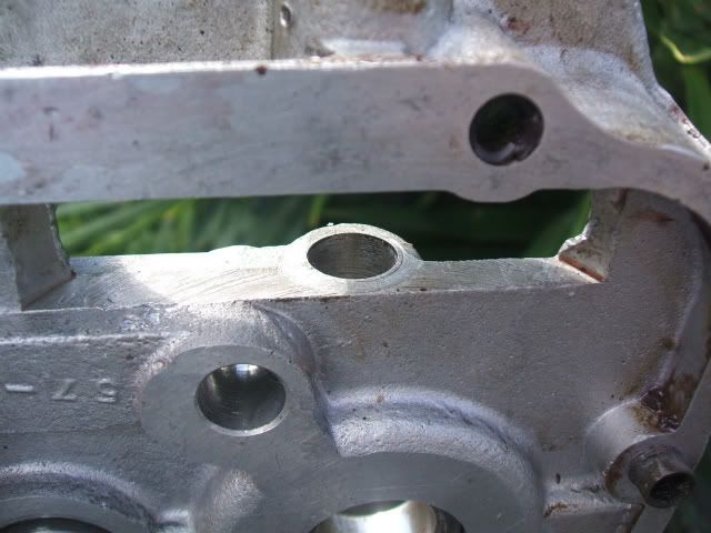

For all your efforts in lightening you seem to have left a lot of material in the outer cover. You do not need the re-enforcement around the non-existent kickstart spindle. The screw bosses for the shift driver spring plate can be cut away from the bottom of the screws to the outer cover.
The pin area in the case started out too low or was worn/deformed by the quadrant? The split pin is so the bearing area is the full width of the pin in the case and not just the quadrant wearing on the pin. The driver dogs work in an arc so they push the quadrant sideways as the lever moves.
The crack is between the 1st and 2nd drive blocks of the quadrant?
I do not believe that shimming the kickstart spindle would make much difference. The drive pins are spring loaded against the quadrant so it is always being pushed against the outer cover. I have put needle bearings in the case to reduce the friction. Kasenit can be used to add case hardening to the surface. The shift shaft is rather soft and roughly machined.
The camplate should be as close to the shift forks as possible. It pushes on the fork pins which tries to rock the fork on the shaft. Have you checked the squareness of the forks to the shaft?
The pointed camplate stop plunger creates a lot of drag and usually wears a groove in the edge of the plate. A plunger with a straight tip (like a line contact rocker) would decrease the drag. It needs "ears" to capture the camplate so it remains square to the edge.

Crack position. Faint I know, but I missed it from the start! That tooth is bent from impact.
I thought about this quite a lot when I first modified it. Then a friend turned up and suggested that the cover itself didn't need to be the thickness it was either. The thickness remained the same, being that it was in the too hard basket for the time being. What's not visible is the old kickstart boss is drilled like Swiss cheese. I elected to retain the bossing because it has engine mount bolts nearby. For sure, more can be done here. The plate screw holes to outer cover webs only need keep captive the springs, but again more can be done. The cover itself feels like a heavy lump when compared to any bike modern covers. Any work done cutting away aluminum seems like little reward but I can't think like that. I need every "edge".
In review of this, I weighed the cover. 760grams (1.68lb) I think now, the kickstart boss can be removed completely. Also the boss in behind the inner cover can be slimmed down as well. 760grams is a lot more than this cover needs to be.
Yes, the pin area in the case started too low from new. I'm not convinced the pin needs to turn with the quadrant. Perhaps my thinking is wrong, please elaborate. The quadrant getting pushed sideways by the driver dogs working in arc is what I reason is at least one issue. It would possibly account for the "locking solid" of the gearlever.
Needle rollers is an interesting mod and the kasenit I've been wanting to get some for a while now. Is the shaft and the bore in the casing a nominal size or was machining necessary? How did you seal the shaft for oil.
I once adjusted a pre-unit box with a 5speed cluster for my circuit bike in the manner you describe. If I recall these have a bushing which can be moved to adjust clearance. Logically, the camplate should be close without giving friction interference. Squareness of selectors needs a better inspection, after all I missed the crack in the quadrant.
Another interesting observation. My camplate isn't showing any wear from the plunger but it's not to say it can't be improved for drag. Good tip about the plunger needing ears so it can't rotate.

Yes the clutchless shifts work surprisingly well once the art is mastered. I remember 1st learning the technique in the early 70's riding a Trident. Several circuit race seasons of clutchless shifting in the early 90's on the Triton gave no trouble from its' 5speed.
I'll wash and inspect all the cogs, and check bushings as you suggest. Yes, the box was built from leftovers or otherwise rejected parts. In fact the whole engine is too. It's a wonder it goes as well as it does. Mismatch issues can surprise you for the darndest of reasons! Gearbox is all B range, unless I'm mistaken.
Yes, I'm aware there is a difference. One of mine has an shallow groove which if I recall indicates 5speed while the other has the identical cutaway. I've had to troubleshoot bikes with 4speed pawls in 5speed boxes before. That fault gives different symptoms.
I looked at the Shenton book. That was early days for 5speed!
The bulb through the sleeve gear is a super cunning idea.
I think you're suggesting that the lever hasn't come back to its' home position in order that the upshift pawl can latch into the next "tooth". In order to test this possibility, I increased the spring tension by adding an extra spring, externally to the gear lever, . The "lock up" problem was exactly identical, no change whatsoever.
Thanks. It gives me time to reflect and consider some possible solutions.

Just to expand on Dmadigans comment on putting ears on a straight line plunger why not take it one step further and include a small roller between those ears and reshape the detents to match. This should make for a much smoother operation and is how radial engine aircraft cam followers are designed to follow the track of their cam ring. I'll have to look and see how much room is in there, I never thought the pointy plunger digging into the cam idea was optimum...Mark

It appears to me that the later style is less likely to find false neutrals because of the ramping/funneling effect of the detent design.
But it is a simple matter of grinding the edge of the earlier camplate to more closely match the later version. Although a time consuming job when done by hand, and a well dressed bench grinder, I have been modifying the earlier camplate for years. I want the tracks from the early leaf spring detent combined with something like the edge pattern of the later.
Personally I use, and prefer, the plunger on the right of your picture. It isn't "pointy" as described by Mark, but once in the camplate detent "V" accurately locates the camplate. I also have a cutaway gearbox that allows me to check the operation of the bits before I put it an engine (There is a picture of it in an issue of Vintage Bike).
Triumph spent an awful lot of money developing the early version of the camplate. Rather than machining the track with a cutting tool, it was punched.
