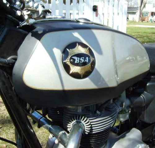

Well, I got it.
The bike it's going on is a '71 Lightning. One of the best riding Brits I own, but never cared for the little US tank and the gaudy tin center stying strip. But this bike is way too good to let sit. The conical front brake works a treat, and I did a bunch of work on it many years ago. So with the new Home Market tank I figure it will get the attention it deserves.
Now I've got to figure out how to restore/paint it. Unfortunately, it is the Triumph version, with no mounting lugs in the tank for emblem screws. And the OIF BSA metal badge doesn't really fit the contour of the tank.
Questions: Is there a different metal BSA emblem for the larger Home Market tank? I think the Home Market tanks used the metal emblem like this bike (not mine).....
Or better yet figure out how to duplicate this one...
This one has to be custom, right? confused It sure is purdy!!
Or I suppose I could just use a decal. Or make it a custom paint job. I always wanted a tank painted in the British flag scheme, but never got around to it. LOTS of work to do it in paint. A wrap might work though. Has anyone seen or know of someone who does wraps for motorcycle tanks?
I did talk to a guy about it, and he is considering it for a wrap, but he thinks it will be hard.
Any other ideas?
Thanks!
According to the A65 parts list for 1971, the BSA Home and general export A65T & L fuel tanks also had "BSA" transfers/decals that year.
(60-3269)
http://www.britishspares.com/138.php
http://transgarp.dyndns.org/motorcycle/pdf/Magasin/TRIStock.pdf
60-3269 TRANSFER - `BSA` TANK - A65 OIF `71
Interesting. I like the metal badges I have from the small tank, but they don't fit perfectly to the contour of the large tank. They rock just a bit. You could use them, but there would be a slight gap when installed. That might just be the way they were, and I doubt there was a different metal badge for the large tank.
The big issue there would be welding in the lugs. I'm not a good enough welder to do that, and any risk of ruining the tank would be unacceptable. I've been looking for a decent one of these for a long time, and they are HARD to find.
Anyone have any hints on the wrap idea? I've seen tanks painted as the British flag, and they are stunning. I just don't have the motivation to do it myself right now. Don, would you be interested? You can email me off list if you're thinking about it.
I still think a wrap might work.

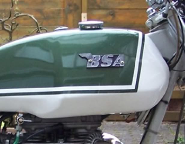

Look at Ger's '71 T-Bolt. It appears to have the metal badges.
http://www.mijnalbum.nl/GroteFoto-YGQUO8CU.jpg
Good score on the tank! I missed out on a '79 Triumph tank which only brought $103. Don't know if that would fit, though. I think Triumph made subtle changes to the wet frame.
That tank is from a 1977-on T140. Metal Triumph/BSA badges were introduced for 1972 on the Home & Gen. export tanks. The cross-brace was also added '72-on.
Yeah, that's the one. I might be tempted to go back to stock if I could be sure of getting the lugs properly welded in to secure the metal badges.
That tank is not from a 1977-on T140.
That tank is the original tank which the factory installed on that bike in 1971.
The badges are metal castings, screwed onto it in 1971. The tank had a respray twice in its lifetime.
You have me wondering now Ger.
You bought that bike new in 1971 did you?
I don't see how it could be the original tank. It doesn't have the raised top seam, and the fuel taps/petcocks were not fitted in that position until 1977.
1971 parts list:
Even the screws holding your BSA tank badge are not in the normal position. They appear to be spaced at the distance and odd heights suitable for the Triumph tank badge. The only A65 "BSA" tank badge was part 60-2568 which was fitted to the 1972 model Home & Gen./Ex tank as well as the 1971-'72 export tank.
60-2568
http://www.google.co.uk/search?q=bsa+60-...348&bih=682

I just noticed the screw distance in Ger's tank. Yes, the BSA holes were much closer together.
I would be using shoe goo to hold dummy screws in place and the badges onto the tank.
This bike is far from original but it is a 1972 model and shows all we have been mentioning.
60-2568
Now this is interesting. The screws holding on Ger's badges are different.
Mine are like the badge pics, much closer together.
Now I'm completely confused!!

Not to get picky here, but there seems to be a big difference in the location of the badge on these two versions.
Just another detail to consider.
