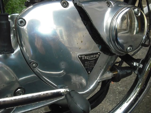

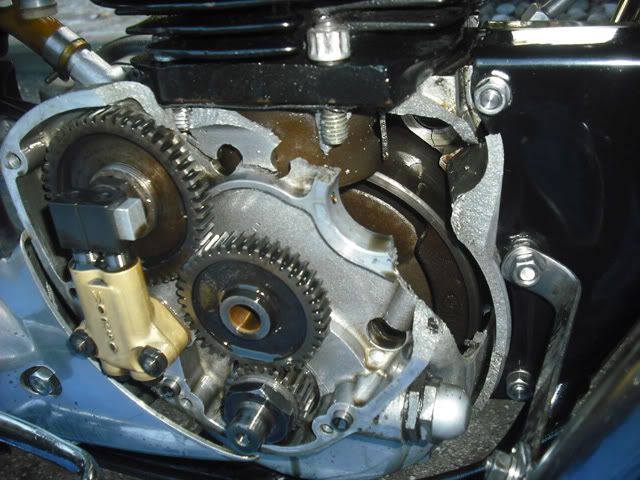

A couple of pictures of Armageddon 2010:
Really it should be registered now as a 2012 model after all the new stuff in the bike.
I had to get new cases, new barrel (re-bored +0.040”), pistons, new exhaust camshaft, the old one was little bent.
