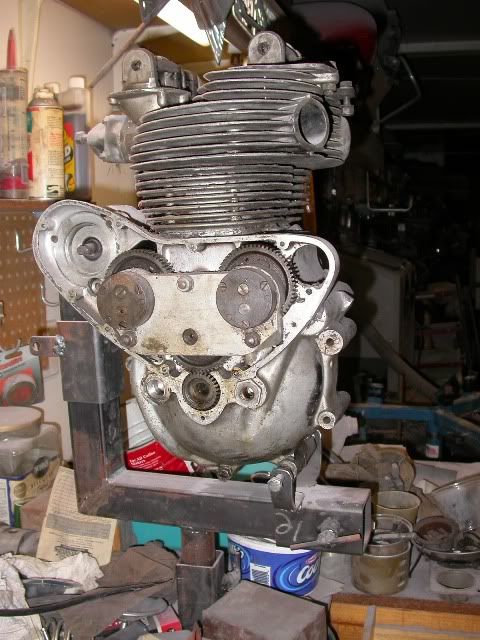

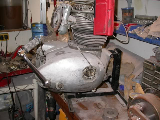

Interesting topic. Trident man makes an excellent point, and the bike itself is likely the best "stand". However, there are other times that a free standing fixture is useful. As noted, they are available fairly cheap or you can build your own. I've done both, with satisfactory results.
Here's one I bought off eBay for unit BSA's works pretty well.
This one I built, originally for a Triumph I think, presently being modified to handle a Matchless.
However, there are times that you need to adapt. For example:

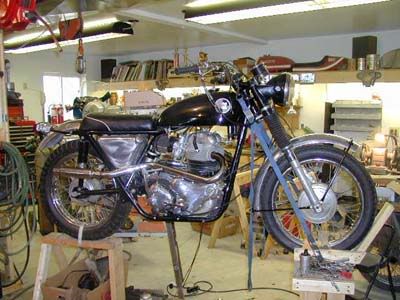

I built this stand for a P11 project, because it wasn't enough just to get the bike up in the air. I had to get under it to get the motor and trans spacing right. I still use this stand for other bikes, mostly pre-unit types that need alignment. Easy to build and works like a charm.
So you have options. Just buy a simple stand or better yet use your imagination. Design and build what works best for your particular situation. grin
PS. Pardon the mess of my shop workbench. Been a really nasty summer!
