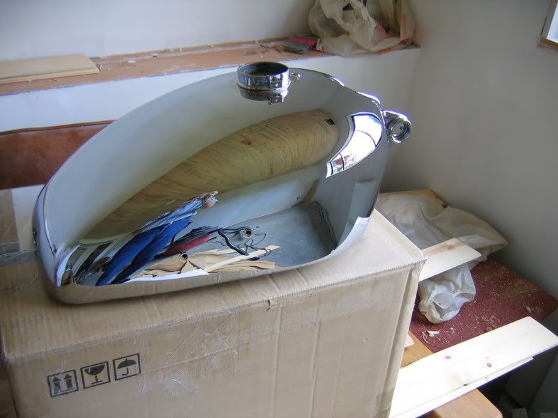

After a rather long wait I finally have my petrol tank back. A couple of questions though.
Does anyone know what thread and dia the bolts are that hold the small tank badges on? These are the B31 style type that are just the BSA logo.
Second does anyone know what colours these badges should be painted?

Suns a little low for any good pictures but you get the idea. Just waiting on a fuel tap now and the rear chain guard. Tank didn't quite turn out as well as I had hoped but it will do until I find a better one.
I ended up going for matt silver lined in maroon in a B31/B33 style rather than the Gold Star layout/colours. I think it works ok.
One of my twin boys beat me to first sit on the bike but I guess it'll end up being his anyway one day.
