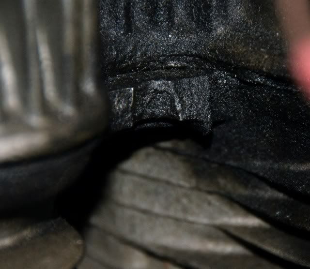

Hi Paula,
Would really like to see a pic of the broken head steady tab on your engine. Never seen one before. Anything can be repaired......
Cheers~Bob

Here's the pic.
I'm open to repairing if that's a reasonable option. I'm dubious about buying a used head and then still having to sort that one out.
