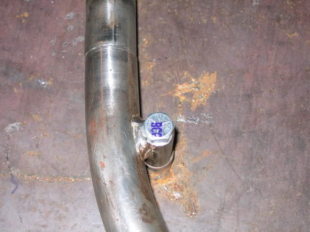

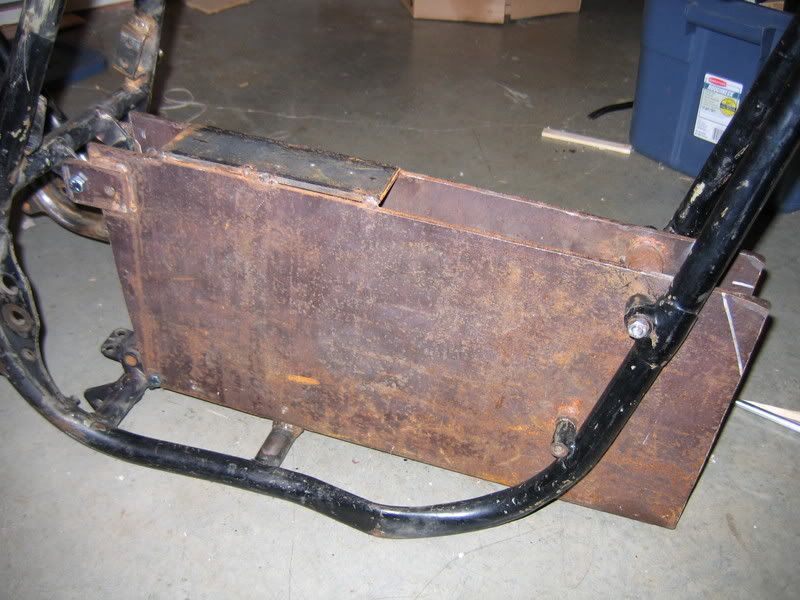

Boomer: This is the alignment jig built by an engineer pal. It is of fairly heavy steel plate with some pass through holes and at the front threaded holes for bolts.
We did see a few 350 GS machines but not very many.
For this frame I was just straightening it out to line up the holes.
This is the 58 frame with a new front lower front section with inner sleeves at the joint waiting to be welded.
